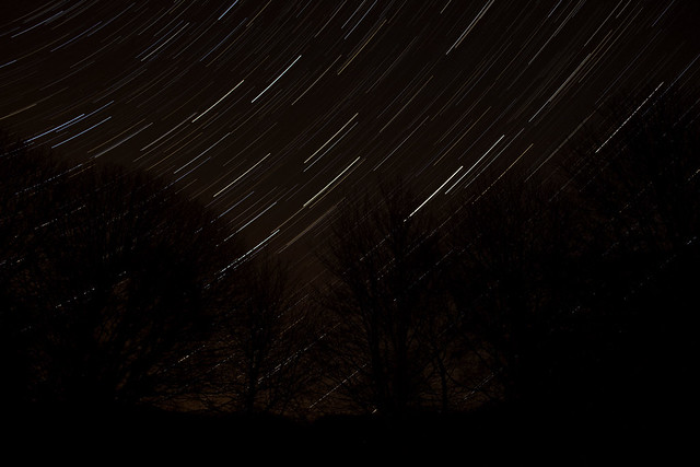

Malvern Star Trial by BenMDavies, on Flickr
Well you've got some trails in there Ben :thumbs: so that's the start :thumbs: but overall it's very dark, what were your individual photo settings?
Matt
Cheers, I think its too dark partly down to me boing a bit crazy with the levels on PS.
Settings used were: F4, ISO 800, 62x30s exposures
That explains it :D
