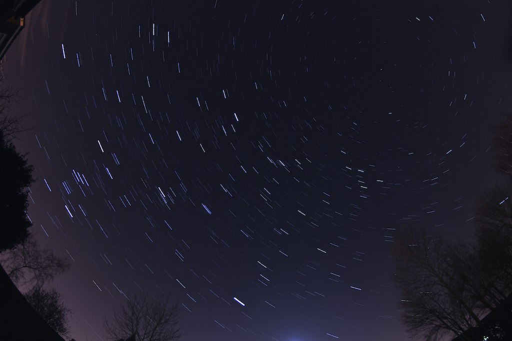

Currently stacking them now! Got a good amount of movement, there 184 images at 30 seconds exposure and f2.8, 30 seconds exposed good amounts of stars.
Let's see how it turns out!

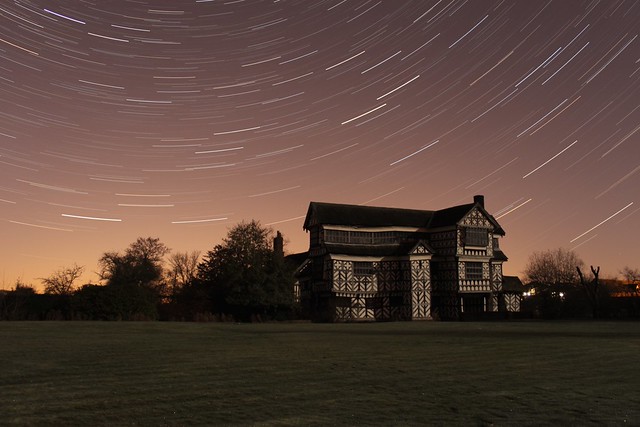

Here it is!
I'd love to have a better foreground, but i'm going to travel to a specific location next time and try the whole sky with my 8mm samyang. I also think that 20 second exposures would have been enough to satisfy it, but hey, i'll apply it next time!
First shot went well, thanks Matt for the guide!
Cheers! IIRC it was about 50x30second exposures, F8 and ISO800
really chuffed with how it turned out
As you should be :thumbs: consider opening up a little more as that will help you pick up more of the stars :thumbs:

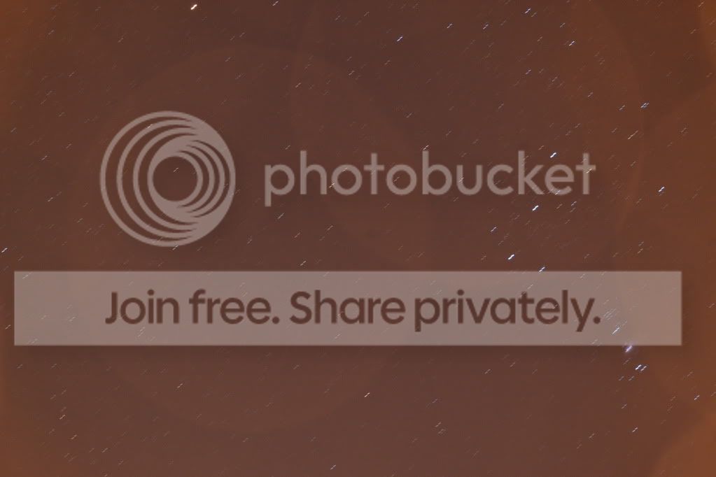

hi matt gave star trails a go earlier to-night, just to get the feel of it, only took 75 pics, loaded it star stax processed images pushed output and image was white,:bang: any ideas mate
ps cant believe how much light pollution there is
I know it's terrible the amount of light pollution :( I cannot be sure exactly what the issue is, do you want to post a single frame from your set just in case that is the cause of the issue it may be because of how bright the whole image is but hard to say without viewing it :bonk:

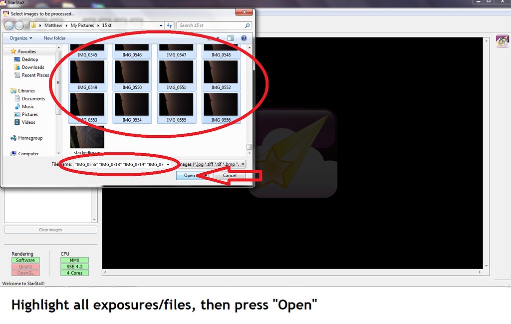

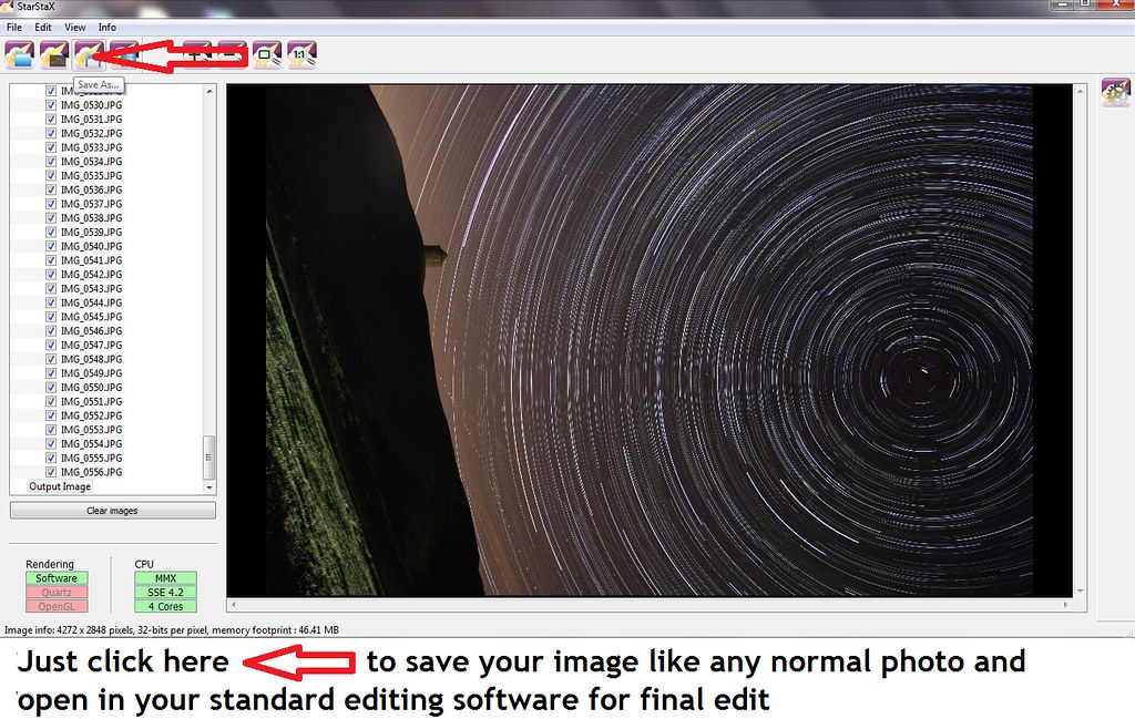

I've just made this up in the hope that it helps
StarStax Pt 1 by mwhcvt, on Flickr
StarStax Pt 2 by mwhcvt, on Flickr
StarStax Pt 3 by mwhcvt, on Flickr
StarStax Pt 4 by mwhcvt, on Flickr
Matt
I take it that there are two images there layered together based on the break in the trails?
Now there looks to be some quite pronounced flare in there, did you have a filter fitter at the time?
When stacking in StarStax when watching the stacking process to it get progressively lighter while stacking?

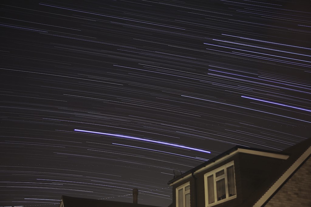

Matt, i had nothing else better to do this evening so i tried another with my 8mm samyang.
Didn't turn out amazing as there was loads of planes and annoying disruptions, otherwise it would have been pretty neat. I had to take them out it just looked awful. Below is another stack that i made and turned out better trails wise, but still.
If it had been clear I would have been out myself :bang: as really want to test my sammy on a star trail, they both look good but my concern is the large/pronounced gaps in the trails, what are you using to trigger your exposures you looks to be having large time lapses between exposures :thinking:

That's where i had to cut out the planes etc, the top one is an edited version of the second one.. even the second one went horribly wrong.
I'm just going to try something with the files i've got.
EDIT
here's one that's not all of the photos, had to cut 100+ out hence why the trails aren't huge!
that's very good :thumbs: I think however based on your location, you like I do will have to star cloning out planes if they are too much of a pain to your trails you can do this either on the stacked image or the individual frames, personally I do it on the stacked trail :thumbs:
