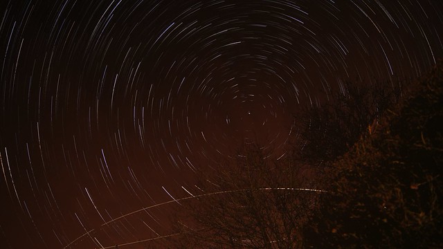

I tried this the other night. It was perfectly clear apart from one cloud that came through (its in about 8 shots). Could you just add the cloud shots into it or can you remove the cloud shots without it messing up the star trails? It came through in the middle of my 3 hours out. Do I need to bin it and try again. Might still be ok for a timelapse video for something. :D
Great tutorial!
You cannot just bin them I'm afraid as that would result in a gap in the trails that personally I don't like to see :shrug: but from the sound of it you should still have a go hour+ startrail, and as you point out it should make for a good time lapse image :thumbs:

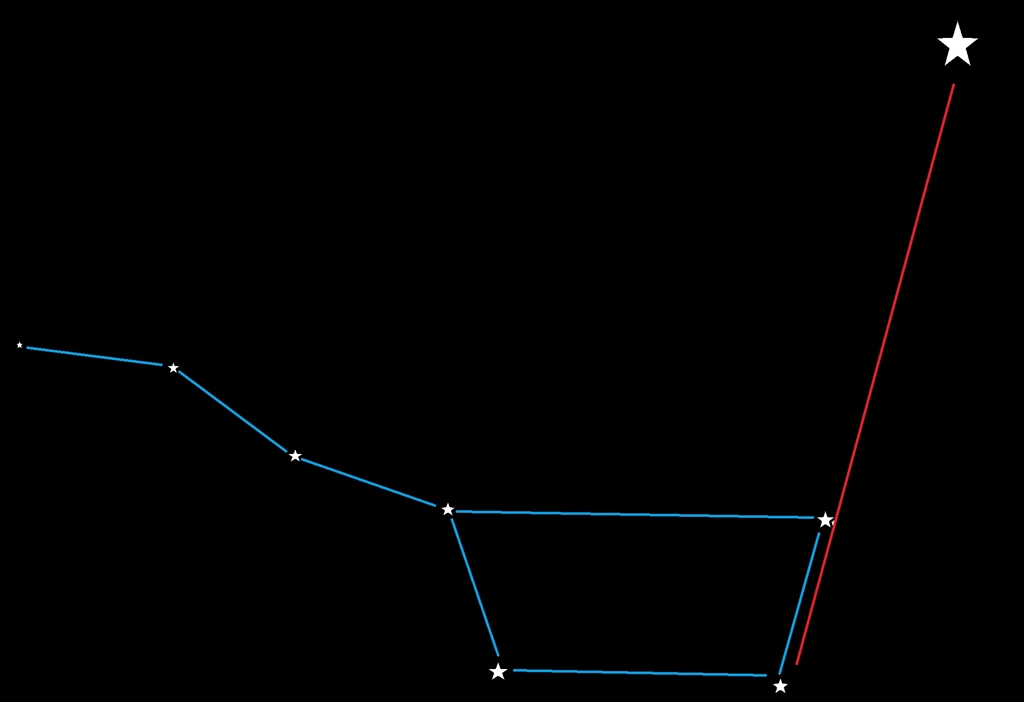

Oh and your Polaris finder isn't working, apologies if this has been mentioned before I skipped to the end of the thread:naughty:
Currently working on a new improved polaris finder developed/photography by Andrew (AndWhyNot) that should be sorted soon :thumbs:
This is the old version :D
Polaris Finder by mwhcvt, on Flickr

Just completed a 1hour stacked exposure, just in the back garden with no foreground, so I have a lot of trails but nothing else. But at least it's given me some idea of the process involved.

Great :thumbs: I'm pleased it gone well for you I look forward to seeing an on location trail :thumbs:
