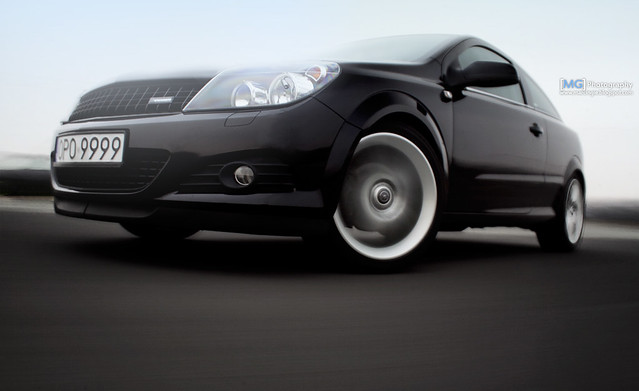

Yeap, I know thatThey're good, your PP really pulls the Tarmac detail out. Problem is, you need a wider lens/longer boom!

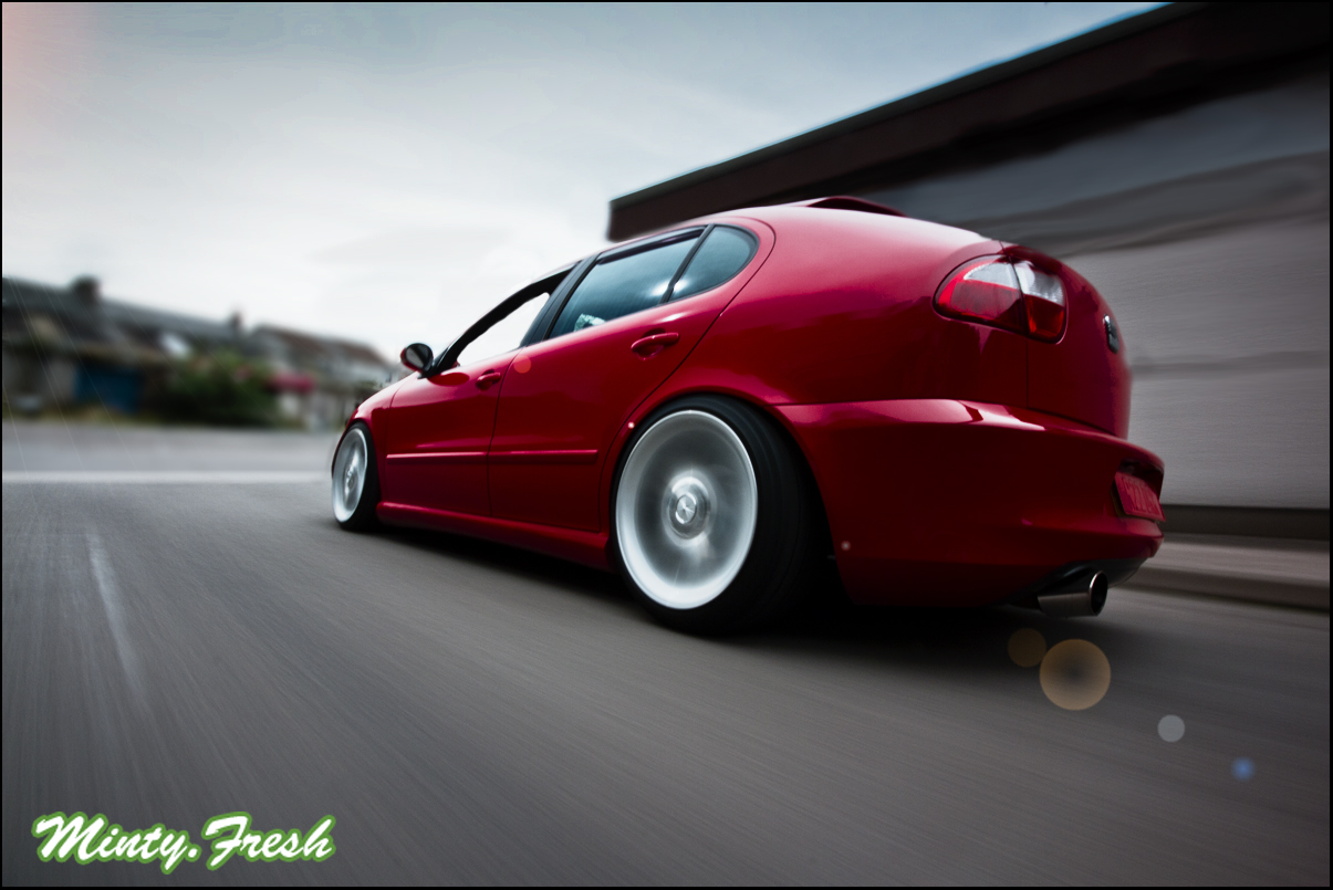

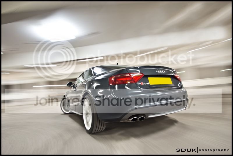

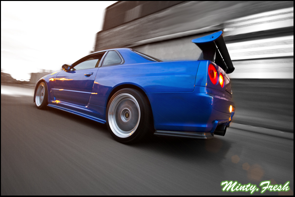

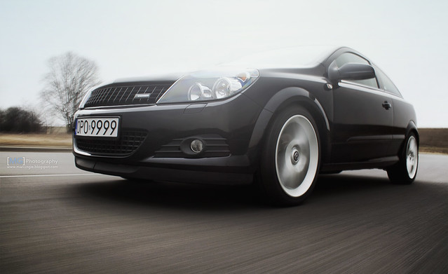

Thanks for your opinion - it's always good to have some constructive criticisizm#2 is by far the better of the 3 imo, #1 and #3 are both blown from the sky and the way they have been editted has blown the headlight area and front bumper, the side of the car looks good as does the tarmac.
Maybe something to look at next time![]()
Thanks for your opinion - it's always good to have some constructive criticisizm.
However, the editing of the sky and this white gradient have been done on purpose to add that bright sky notion.
Cheers!
