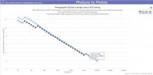

Unfortunately only a very limited number of cameras have been tested to show the DR with both mechanical and electronic shutter on photons to photos, I don't think DXO specify MS or ES.

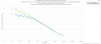

I personally don't think it's much to worry about if this is anything to go by. Here you can see the difference (or lack of) between MS, EFCS and ES

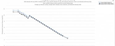

Canon see a significant drop with ES though :thinking:
View attachment 469691View attachment 469692
As I mentioned in one of my previous posts, canon drops the bit rate and/or dynamic range in favour of FPS and fast readout.
Basically with normal sensor you cannot readout all the data quick enough to avoid rolling shutter and shoot at higher frame rate, so they just read less of it :D
This is less of an issue with a stacked sensor in R5ii but on a non-stacked sensor like R6II or original R5 its massive hit to IQ.
I would like to see the results on R6iii when its up but I feel it'll be more like R6ii, may be slightly better but probably not much more if its not even partially stacked.

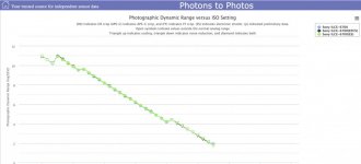

A7V DR tests are out, seems Sony's claims are correct. I would trust these over the Northrups any day of the week. It seems it doesn't have the dual gain of the A7IV though.

Just had a quick look at the video you are referring to, Tony is purely talking about video DR and not stills which I guess is where some of the confusion is. Sony don't mention DR in video AFAIK.
Looks amazing! I guess that would mean this has the highest dynamic range on the market?
But petapixel also mentioned there is dual gain in ES mode. No charts (yet) for ES :(

Was just about to post this and the dp thread where the guy that does this posted
Yeah seems that the didn’t lie regarding DR but they have also applied NR baked into the raw files
yeah they are supposed using some kind of "AI NR". Canon have been doing this since R5/6. they use that technique to match Sony's DR, now Sony with similar method might have gotten a bigger boost.
I *think* with ES a7v probably still loses about a stop or so of DR but that brings it to the level of A7IV because of this boost at base ISO with mechanical shutter.
