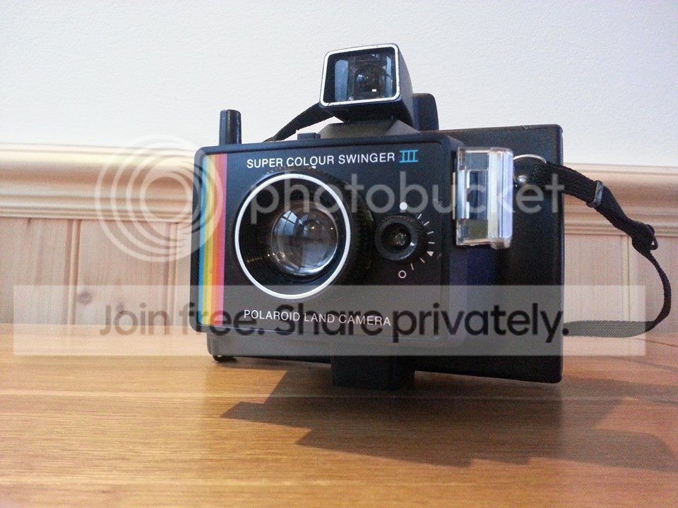

fresh 2xAA and the shutter/light metre jobby seems good :-)
