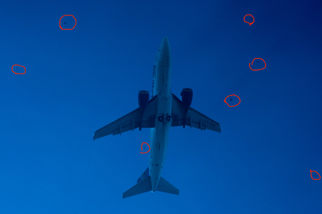

I've had my D800 less than 2 weeks and took it out duck shooting at the park yesterday, whilst out an airliner flew over so I grabbed a few shots, they were massively overexposed so I had a play with them in LR to see how recoverable they were and as I tweaked them spots started appearing so I pushed the sliders a bit further and ended up with the image below. Now I know that this isn't a real world image but I've never wet cleaned a sensor before and have no intentions of starting now. I'm guessing it's oil given the circular nature of the spots rather than dust. Any thoughts...?
Looks like typical dust bunnies to me.
If you really don't want to clean send it to nikon or take it to a shop to get done.

Cleaning the sensor of any SLR is pretty straightforward, in fact it's **** easy! Just get the right swabs for your sensor size and some proper solution for them and bobs your uncle.
Another clean rip off in the photographic industry. Lol

Agreed, it is incredibly easy.
I know I bang on about this, but seriously... what is the big deal about cleaning a sensor? You can't touch the sensor... it's buried behind a thick layer of plastic.. you won't break it. It explains how to do it in the manual... there's a lock up feature built in to allow you, the user to clean it. It's dead easy, and safe, and above all.. it;s routine maintenance you are EXPECTED to do. It's a SLR.. you take the lens off, and crap gets in.. fact. If you are not prepared to clean your sensor, or send it away to be cleaned, then sell your SLR now and buy a fixed lens camera because it happens.. it's normal.
Buy some of these and just clean your sensor. Make sure you battery is fully charged before you lock up the mirror, and use the camera's menu option for sensor cleaning lock up... do not just use "B" and you'll be fine.
You can NOT touch the surface of the sensor.. it's impossible.
It's up to you. Either clean it, or have spots.. your call.
Well obviously it's going to have to be cleaned as I don't intend to shoot at f1.8 permanently. I'm just a little surprised that this is an issue 11 days into ownership.
The D800 is needing cleaning more regularly I find. If it isnt that bad or I can't be bothered I'll just use the clone stamp tool in post.

+1 this are awesome , and if you travel they are easy to pack
It may be oil spots, which certainly was a big issue on early D800's and D600's, it was on mine. Not sure if this is still occurring as bad as it was on earlier models.
Cleaning oil spots off is the same procedure but with a different swab made for oil.
If you use a normal swab then the oil can just smear.
The oil spots stop showing after about 3000 clicks
Incidentally, if you are going to clean your own sensor then it is worth buying a decent sensor loupe such as this
http://www.wexphotographic.com/buy-...se-extension&gclid=cmqjqznyprccfziptaodphoalw
expensive but it means you can really see your sensor
