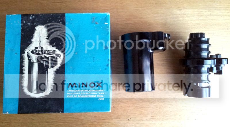

Spiral - no, but Minox used a helix for their sub-miniature daylight tank, with the wonderful German name 'Tageslichtentwicklungsdose'
One of these days I'll get round to using it and the Minox B, although I've no idea what I could do with the negatives.
That's great Nick, thanks. Just when I thought I didn't need any more kit you tell me there's a developing tank called a Tageslichtentwicklungsdose! Now I have to go and buy one and I don't even have a Minox!
