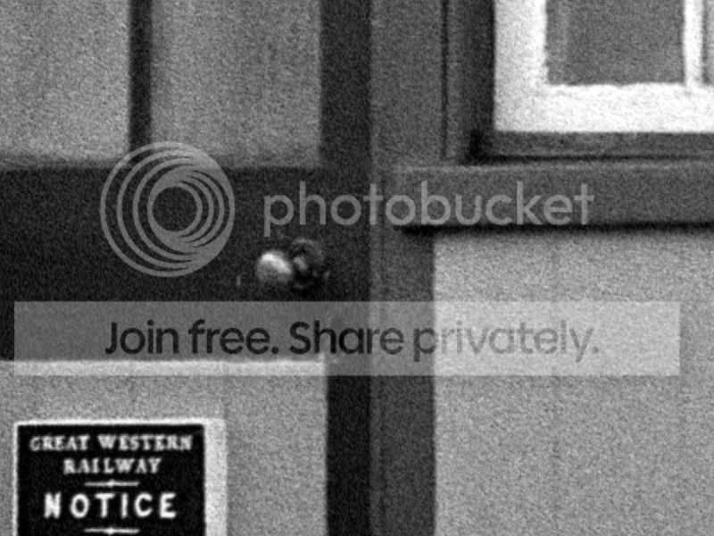

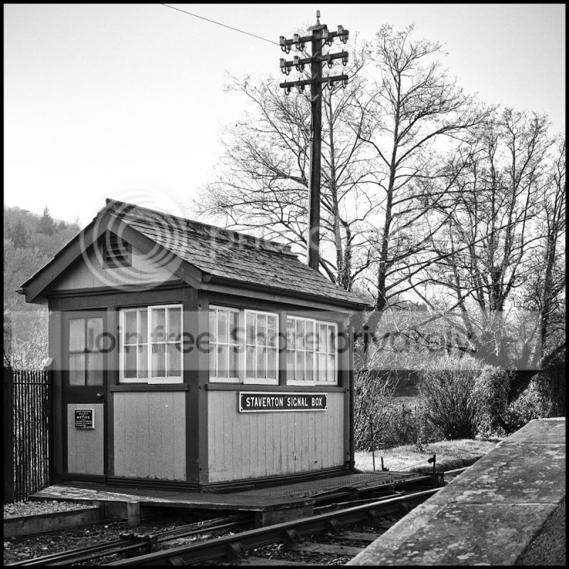

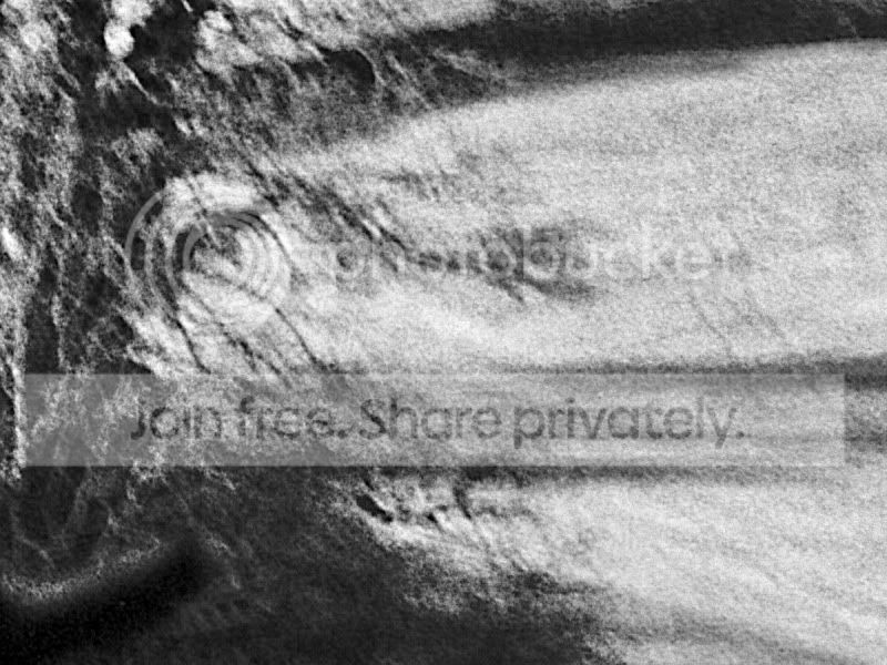

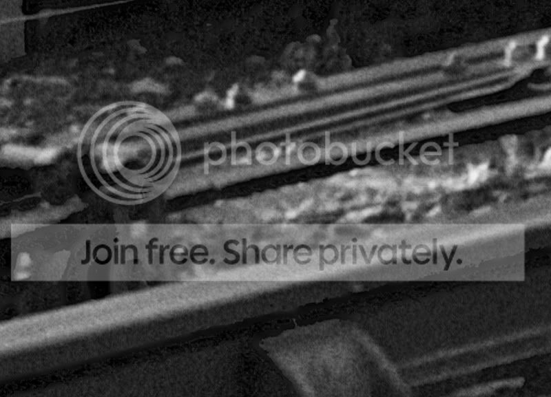

Full image:
Half Full sized image 6000x6000
100% Crop
100% Crop of shadow detail

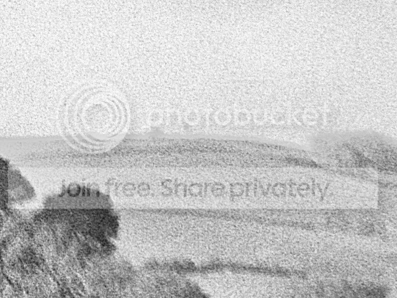

The image below was taken the week before on the same camera, same lens and the same film Tri-X at ISO400 and using my 'old type' processing, the grain is very much more evident especially in the sky area, I will do a 100% crop of the original file later where I think the change will be very much more evident.
These are two 100% crops of the above image before it was played around with in Nik Silver Efex Pro 2 and whilst still at the native 594MB 10190x10190 pixel size, I have added some USM of 80% at 0.8 which is what I would have normally added to that size image, other than that, just as scanned at 4,800dpi with Silverfast 8 on a Epson 750.
