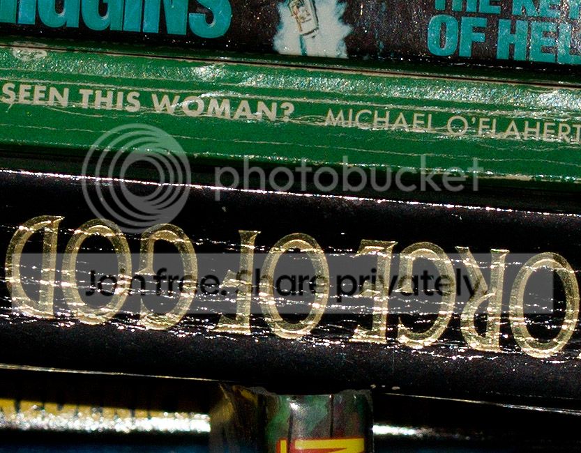

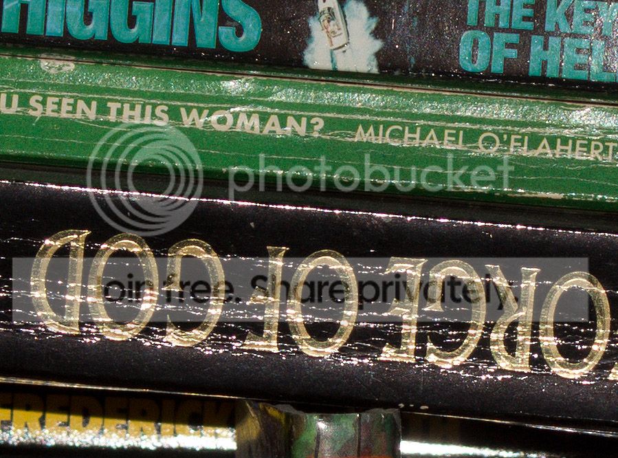

Anyway, I took two indoor shots using flash and a tripod, one with my 12mp A700 with the 70-400mm zoom at 100mm, the other with my 24mp A77 and the same lens at 70mm. Both images are the same scale when viewed at 100% and for all intents and purposes show the same amount of detail.
Here are 100% centre crops. Exif is intact. See if you can work out which is which before checking the exif data.
