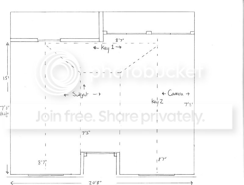

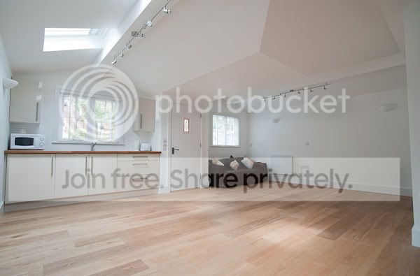

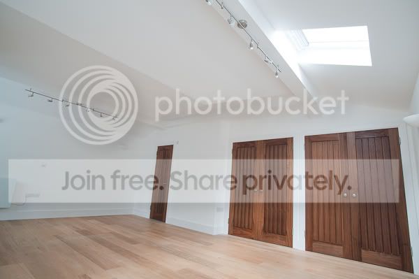

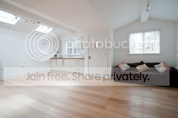

Ok, so my studio is just about finished. The only problem (and it's quite an annoying one) I forsee is the head room, with the ceiling down to 7'3" in the centre.
Here's a few pics of the studio, to get the idea, followed by a sketch with measurements:
This is a sketch plan.
When taking portraits with the key light high right, I could position the key light (octobox) in position Key1 (I could reverse the camera and subject position if I needed the key light high left, which would be a pain, but that's what you get with ceilings too low).
When taking group shots, and wanting the key light directly above the camera, I could put the light (possibly a rectangular softbox on its side) in position key 2, which would require bringing the subject closer to Key2 & camera.
Subject wise I would like to be as flexible as possible within the limits of my studio.
I'm thinking of using an octobox about 95/120 cm for the key light for many portraits, with a fairly powerful light.
I'm wondering if a rectangular softbox on it's side would work for groups.
For balance light (fill) I'm thinking of another, smaller softbox (as I can control spill better than with a brolly).
I'd then like up to 2 lights for the background (one of which could be used as a hair light etc if not do high key).
Not sure which material to go for for the background, but I think 9' wide may not be enough when doing groups and bringing them towards the camera. The walls are white, which could be used for the sides of the background, but that doesn't help with the train.
As for all the walls being white, I thought I'd set it all up and work out which walls/ceilings I had to cover with black material when shooting. I'd like to install some clips/brackets etc that material can clip onto and stretch between.
So...
any advice on what kit to buy, and where to position things will be very appreciated.
Thanks
You seem to have put a lot of thought into this, and you're right about the limitations of the low ceiling. You can't make it any higher, but you can paint it matt black, and you must if you want to have any kind of lighting control.
I understand what you're saying about using a rectangular softbox on its side for groups, this will work and will make the best use of the available height. The only downside will be that you'll end up with rectangular catchlights, which may or may not be a problem for you. This Lencarta strip softbox is worth considering.
I don't understand what you're saying about portraits - unless I'm reading it wrongly you seem to be saying that you think that portraits should generally be lit with the key light on the right and the fill light on the left. In fact, having a light at the side is only really a good idea generally if the subject is a full length shot, for headshots it generally produces a far better result if the light is above the camera (or above where the subject is pointing), because light from above produces good modelling and defines the shape of the face well - that isn't a rule of course, there are no rules because every subject is different.
And as for the fill light, that goes where the camera is, on axis with the lens, so that it illuminates all of the subject as seen by the lens. In any other position it isn't a fill light, it's a second sun - and there's only one sun on my planet:)
And the fill light can be literally any kind of light you want, it's a bit pointless using a softbox for it if it's placed behind the camera (the normal position) because an umbrella is cheaper and will do the job better (because it spreads the light more).

Hi Garry, thanks for the reply.
That's what you think :) Ideally I'll be able to stretch material across it, between my ridges, because the building also doubles as a place for people to stay.
I think I (or more importantly, clients) could cope with window shaped catchlights. I had thought of the 140x70, as I wasn't sure the 140x30 was enough - the 30cm option would no doubt fit more easily.
Not specifically right & left, equally vice vera, but yes I do like portriats I've seen lit that way.
Ok, I will research more and play when I get the kit. What I'm picturing also defines the shape of the face well, but doesn't light the face equally on both sides.
I'm not talking about equally powered lights - more one sun, and balance light coming from refelctions off buildings etc (which is why I call it balance light, rather than fill). Maybe I'll learn that your way is normally more useful.
What I had in mind had the softbox in front of the camera, just out of shot. The reason I was thinking of not using a brolly is because I don't want too much light hitting my white walls/ceilings.

From your photos, I would be very happy to make that space work as an excellent portrait studio. It's not as if you're getting cars or massive stuff in there. By the looks you're not going to get much light coming back off the far walls etc, but I would certainly black out the ceiling above the shooting area and use a few screens.
