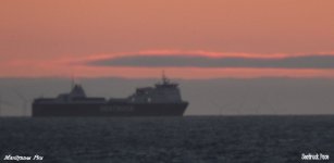

The below were with a 150 - 450 zoom @ 450mm - F5.6 - 100 ISO - 1/200 sec handheld
The first is the original and the 2nd is the crop from the original

@MarilynneT both examples look like from your fotga super tele? The shutter speeds are rather low for such a long focal length, and the moon moves rather fast so it looks like motion blur to me. I'd try a much faster shutter speed and see if you can do more to keep the lens from moving - the slightest breeze will make the images blurry. You may well be better off using your canon 70-300 and cropping.
also - quite convincing evidence that the earth's surface is indeed curved ;)
Thanks Tim. Yes I was using my telephoto but I'll try your recommendations and see what I get.
Following on from Tim's advice, the moon is also quite bright so you can afford to increase the shutter speed and then bring some detail out in post, aperture wise F5.6 to F8 is about right.
Try handholding but leaning against a house wall or door opening etc, breath in and gently squeeze the shutter,
No, just a flat disk. Think of it as a giant, but lumpy, tiddlywink. Orientation such to convince the gullible that the earth is a globe.
I would suggest using the Canon tele lens, settings decribed as above, and on a firm tripod. Then crop the image. Reviews of the Fotga (I never knew it existed) are mixed.
