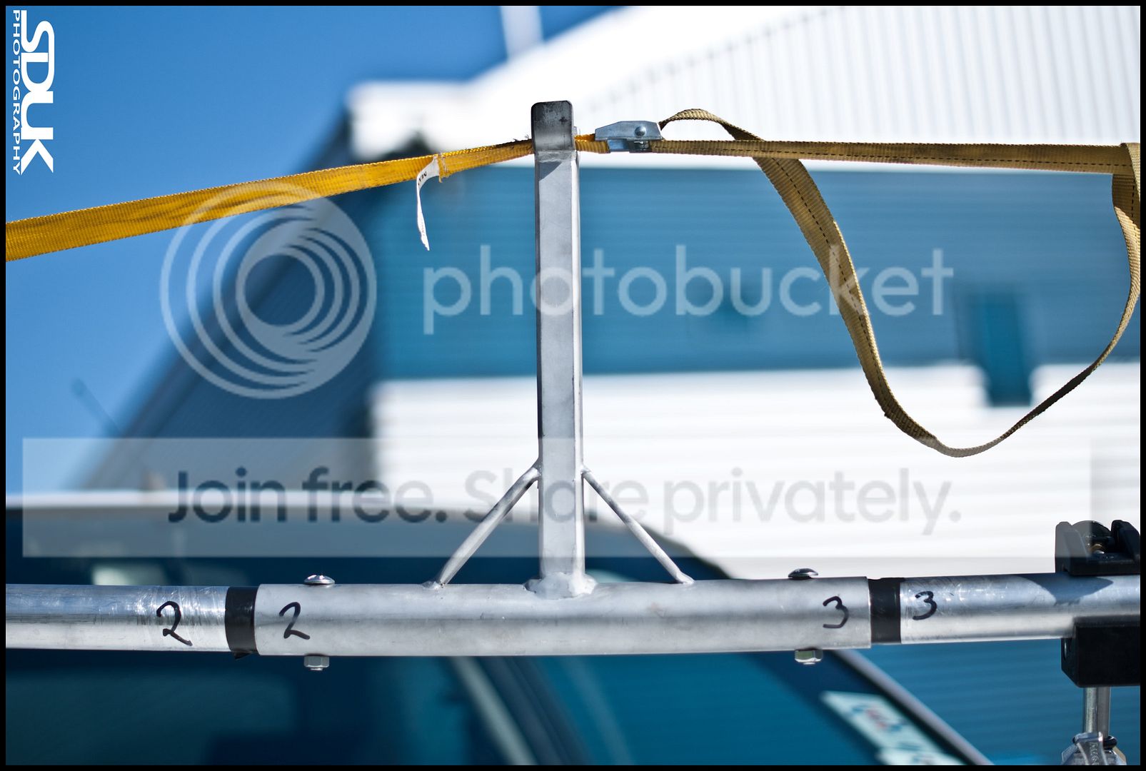

Also took some shots of my rig set up so tomorrow I will post a detailed description of what I use :)

Sammy i love the idea of using a tensioning strap to reduce bounce. Looks like an easier to use method than wire and turnbuckles.
thanks Micky, the strap works really well and is a lot lighter than wire. Plus can be stored easily with not much hassle.
it's amazing the reduction in the bounce of the rig!

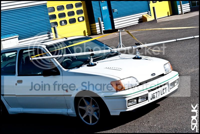

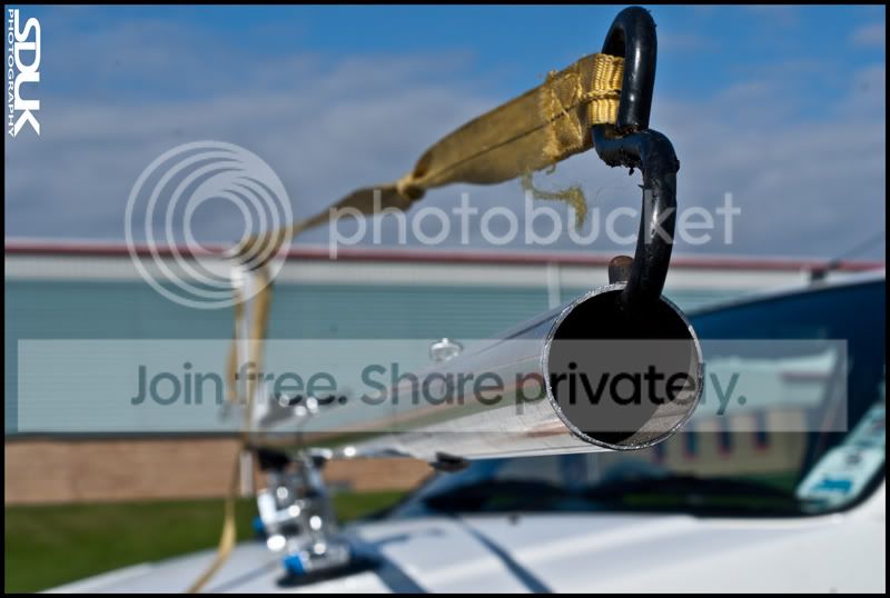

Had quite quite a few requests on detailed info on my rig set up so thought I would try and share as much info as I can.
It really is not complicated or difficult to make!
So here are the details of my current set-up:

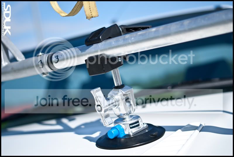

The first parts are 2 x Manfrotto PUMP CUP WITH 16mm BABY SWIVEL SPIGOT - Avenger F1000
These cost about £58,00 each and I bought these from...
http://www.karlu.com/manfrotto-pump-cup-with-16mm-baby-swivel-spigot-p-9440.html
These "sucker" onto your car and can be used on any flat surface.
Once these are fitted you need 2 x Manfrotto Super Clamp 035
These cost about £22.46 and I bought these from...
http://www.karlu.com/manfrotto-super-clamp-035-p-3934.html
These attach to the manfrotto avengers and have a strong grup for holding onto your beam.
Here are the two parts in use on my rig...

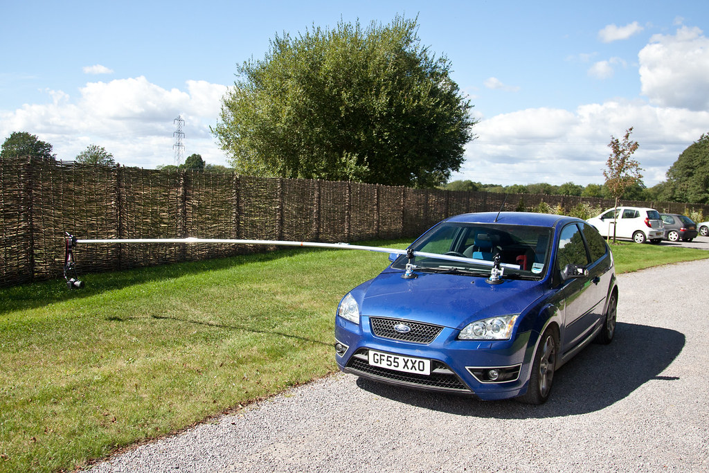

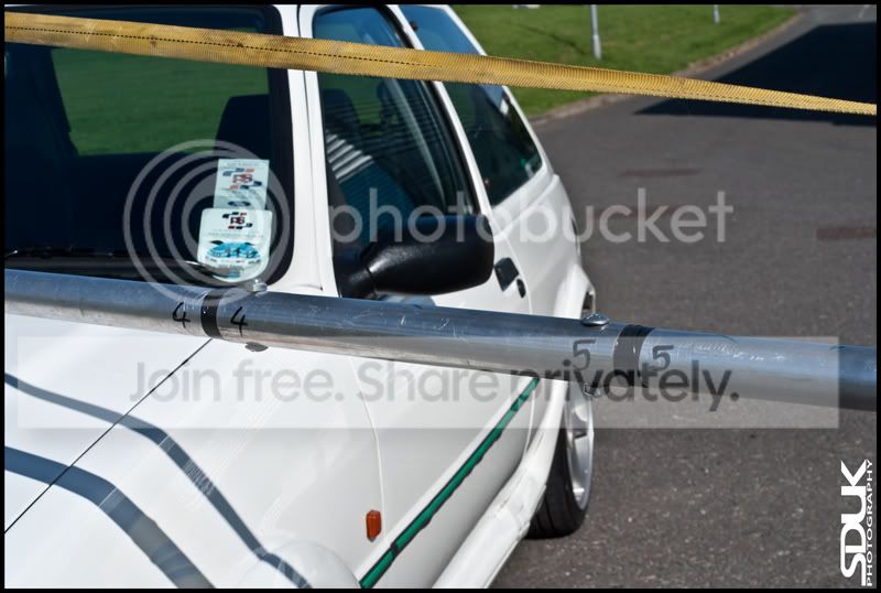

After that you need to sort the main beam of your rig. I went to a motor factor and bought a length of steel pipe and aluminium pipe.
The steel (much stronger) has a slightly larger diameter than the aluminium pipe and can be slid over the top.

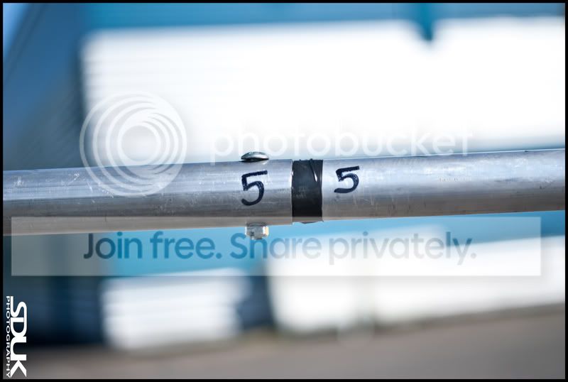

I cut them into three parts each and used the steel pipe as joining sections with the aluminium as the main length sections...
Once connected, I drilled holes through them and fitted bolts to hold it in place. I marked the joining parts with tape and numbered the sections so I know what order to build it once it was dismantles...
Here is a shot showing the thickness of the steel connectors (the aluminium main sections are about the same but slightly smaller in diameter to fit inside...

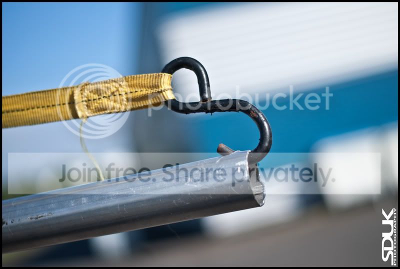

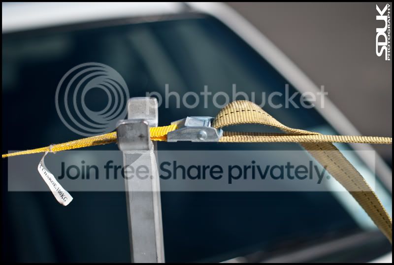

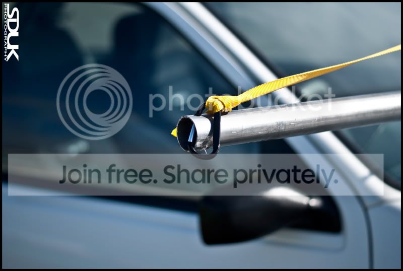

I found that even though the pipes were rigid, the bounce once under load was huge! To counter this I had a friend make a "T" piece out of one of the steel connecting pipes...
I then used a strap as a tensioner and attached it to each end of the rig, passing it over the "T" piece...
This reduced the bounce massively and also didn't increase the weight of the rig too much.
To attach the camera to the rig I bought a Manfrotto Magic Arm with Camera Bracket.
This cost £89.96 and I got it from here
http://www.karlu.com/manfrotto-magic-arm-with-camera-bracket-p-9394.html
Then I bought another Manfrotto Superclamp (as above) and used this to attach to the beam.
The camera then attaches to the magic arm and can easily be positioned for the rig shot...
I think that is everything.
I have just been trying it out with trial and error and I am starting to get the hang of it.
It is good fun and you get some ace shots!
hope that helps those who were asking,
Sammy

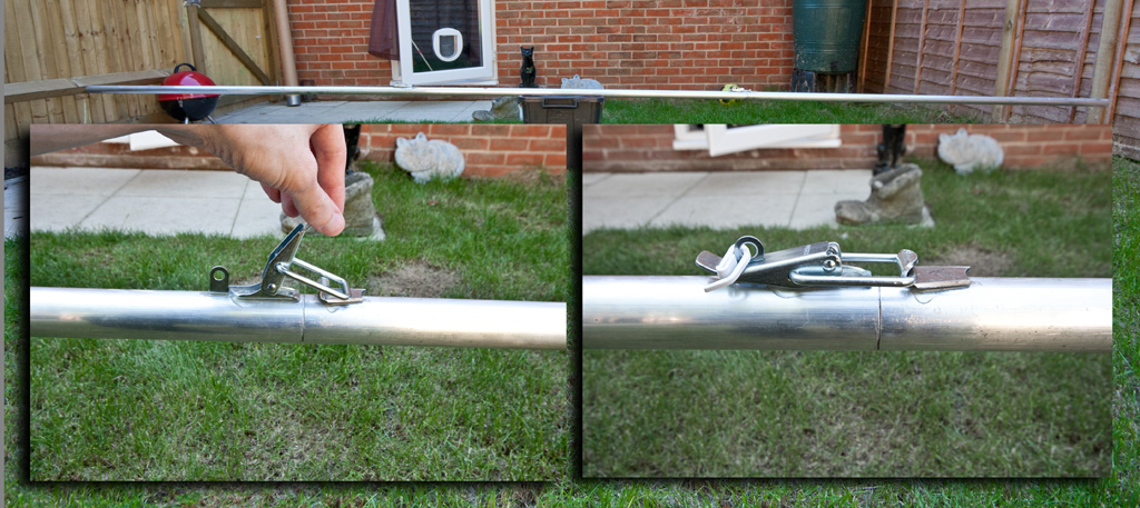

Interesting build guide and thanks for sharing. You may find wingnuts easier to use than normal nuts.

Finally got all the bits for my rig last week so gave it a quick try. I tried it in the worst conditions. Strong winds, gravel road and driving the car ( i have a knee injury so pushing is out of the question). Reasonably happy with it but may make a tesion wire to help some of the flex.
1 1/2" aerial pipe with 1 3/8" connectors. Have done a build log which you can get from my blog.
http://mickyphotography.wordpress.com/2012/09/11/rig-build/

How long are people making their uprights for the tension wire. I'm looking to make an easy to remove system using some kind of bracket (BSP pipe bracket looks promising) And a threaded bar with eye on the end. Will 30cm be enough?
thanks mate. I just tried something different for the close up. I want to try that again on a car with better brakes and maybe another angle to catch it.
In the third picture yeah thats the rig shadow. I tried and tried to remove it but just couldnt get it right. Gave up in the end :)
For my upright (few pics of it in this thread) I got a friend to weld a small metal bar onto one of my extension pieces. 30cm will be more than enough, don't think mine is that long.
What are you going to use to tension the wire? I looked into changing to wire and using an "eye" piece to run it through but couldnt see any way of tightening it as easily as my strap does.
