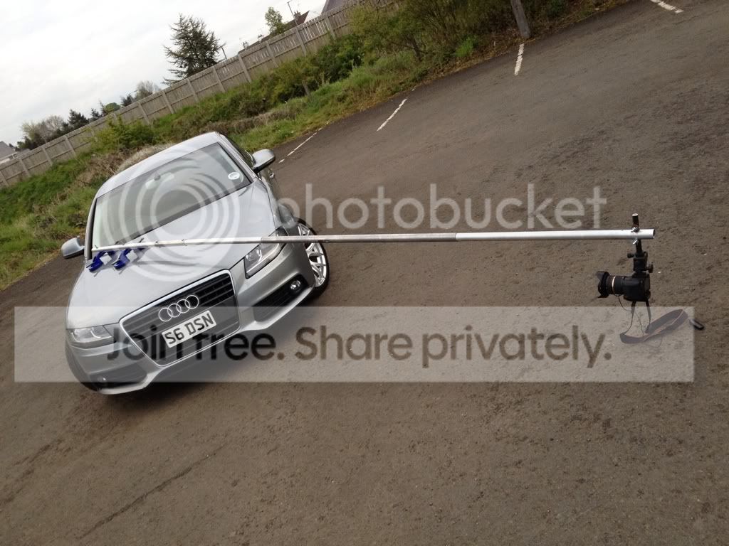

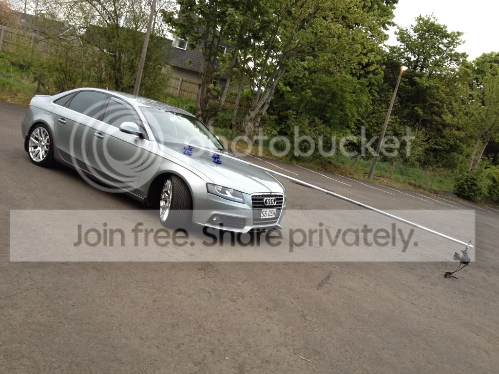

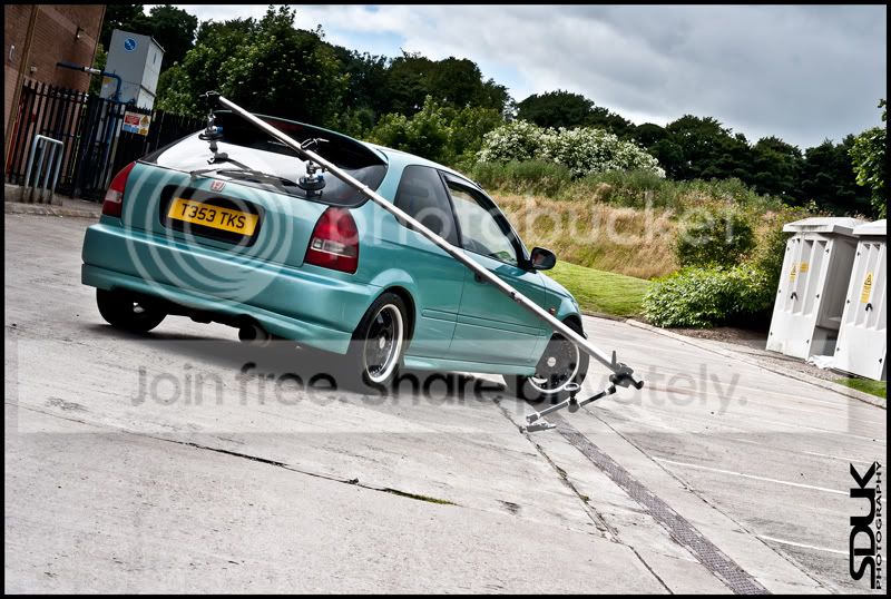

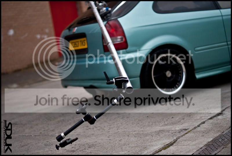

So here was my first rig. I think it must have cost me about £62 in total and is made up of the following parts...
2 x suction pads from B&Q - £9.99 each
1 x aluminium 12ft aerial mast - £12
1 x steel 2m metal pipe - £10
10 x 6mm nuts and bolts - £5
1 x mini tripod - £15
Here is a picture as I was adding an extension piece on (it is now drilled and bolted)...
It was good fun to make and easier than I thought, it easily dismantles and transported in the boot of my car.

so got the new Manfrotto parts delivered and went out for a practice. Here is new the rig set up...
And didn't have long but had a practice couple of shots...

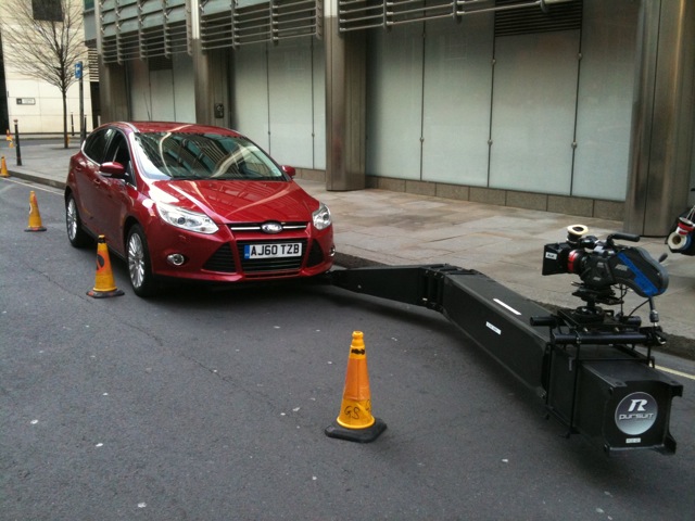

my buddy is a key grip ;)
a shot of one of his car rigs.
