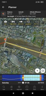

Here's my plan for the tower Bridge sunrise in photopills

Yeah, I've decided I'm going to buy photopills, and as you say, it has many other features. In your screenshot, I presume the red pin is where you're standing and the black pin represents where the sun will be over tower bridge. Did you have to plan elevation too? Also I'm sure this is a silly question, but can you select sunrise or sunset, or you just plan where you want the sun to be and it'll just tell you what time of day that'll happen?
Red pin is where I plan to stand, black pin is the subject i.e. tower bridge. The yellow line is the direction of the sunrise and its thickness tells you how large it will be in the frame which is pretty accurate if you look at the example shot posted above by David.
Yes planned for elevation too... in my plan above the sun is below but it will eventually rise :LOL:
I planned to get there just before the sunrise so I have time to setup and take a shot.
The orange line on the left is the sunset.
