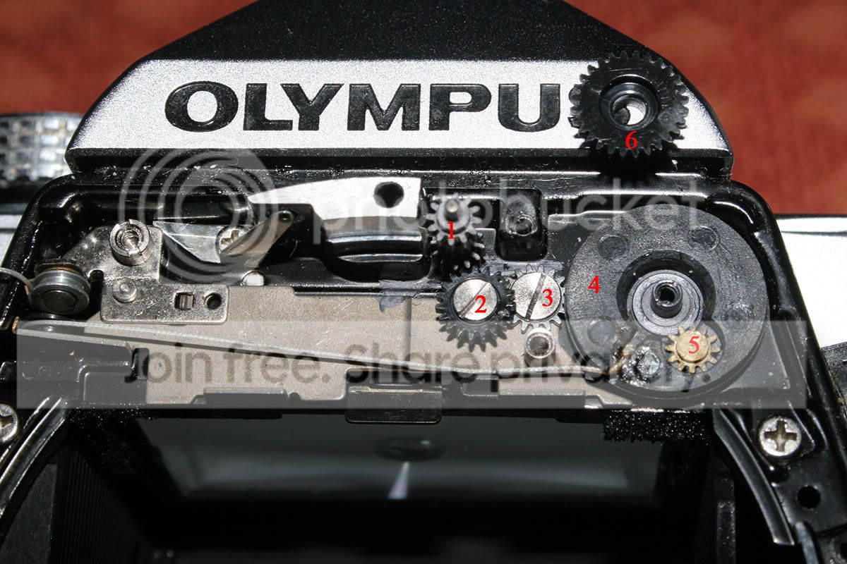

Be careful with OM cameras after the OM-1 because Olympus changed the full mechanical speed assembly with a string based one, take a look to the following picture:
