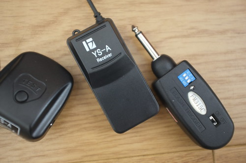

Here are a couple of pictures of the lights and the controllers.
I assume it took so long to send replacements as they were in China despite your Ebay listing claiming you held UK stock.
We had to use rubber bands to gaff the hot shoe controller back together.
I only bought the lights at the time as they were for a shoot for my sisters vintage fashion website which was delayed.
Lesson learnt for me was never buy cheap!
DSCF5507 by glennblackphotos, on Flickr
A shot of the controllers.
It was the hot shoe attachment of the one on the left that fell apart.
I have the broken controller around somewhere too.
