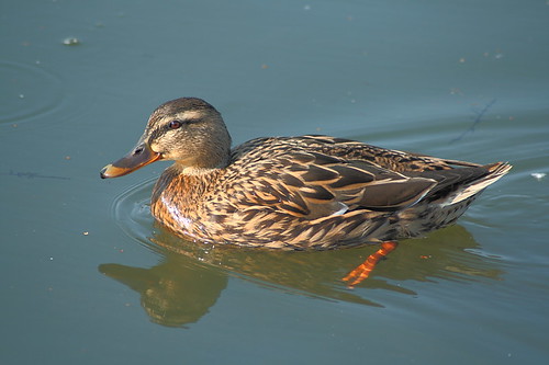

I have this lens and it can be soft in low light , but having said that ,it shouldn`t be a problem in this instance, a lens hood would stop light across the lens ,lower iso and higher shutter speed all contribute.
Here`s a photo with mine in good light and although not at full focal length gives some idea of good light shooting
Duck by Harvey Young, on Flickr
Having said all that i`ve recently got myself a canon 70-300 is usm and there`s been an improvement in quality hope this helps Harvey
