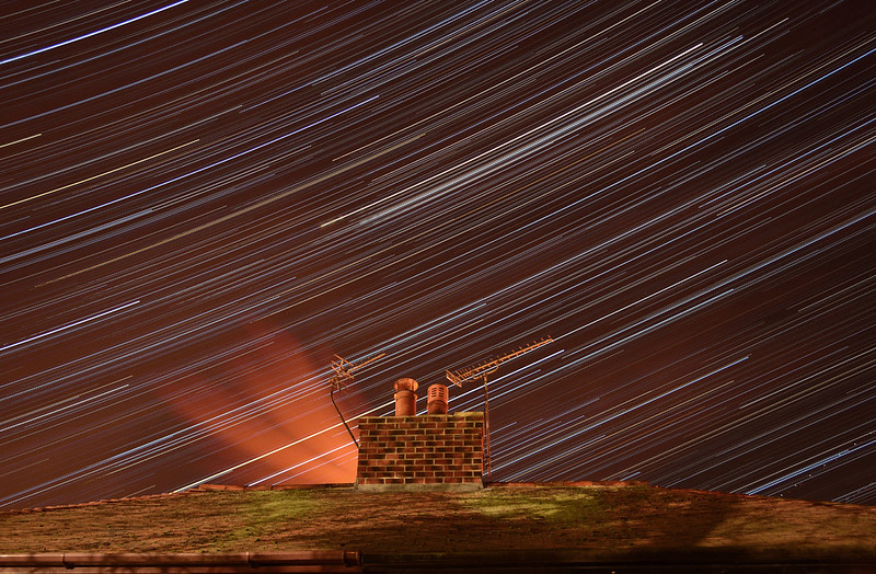

Your photo looks great to me and is something i'd like to try. Do you mind sharing what settings were used.
Thanks in advance.
Thank Matt! I was the messenger not the author!
