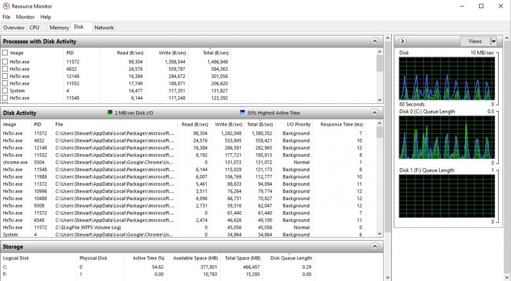

I've noticed that, recently, two of my Windows 10 machines (laptop, work desktop) have slowed to a crawl when they're first booted. The machines are generally unresponsive, sometimes taking minutes to perform tasks which ought to take seconds (eg start Chrome browser, start Lightroom), and seconds to perform tasks which should be almost instantaneous (eg start Task Manager).
Task Manager shows that the disk utilisation is 100% but the actual data transfer rate is very, very low. I've pasted a typical screen shot below.
Has anybody in the TP community experienced this personally? Did you work out what was causing it? How did you fix it?
