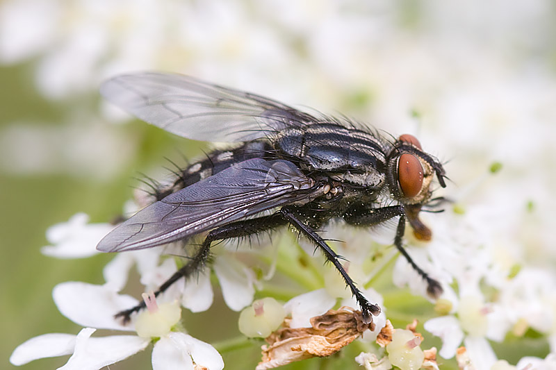

You don't NEED a flash at all. Just get out and use it in some good light, use a mirror, reflector, or improvise with lighting (I use two desk lamps and have my WB set to tungsten) indoors. Whilst I can see a flash has many benefits with macro shots, it really isn't a must. HTH keep your purse strings closed :lol:
Oh, failing that, you can use your on board flash, diffuse it by fastening a few plies of loo roll to the front ... This was taken like that with my 105mm Sigma :thumbs:

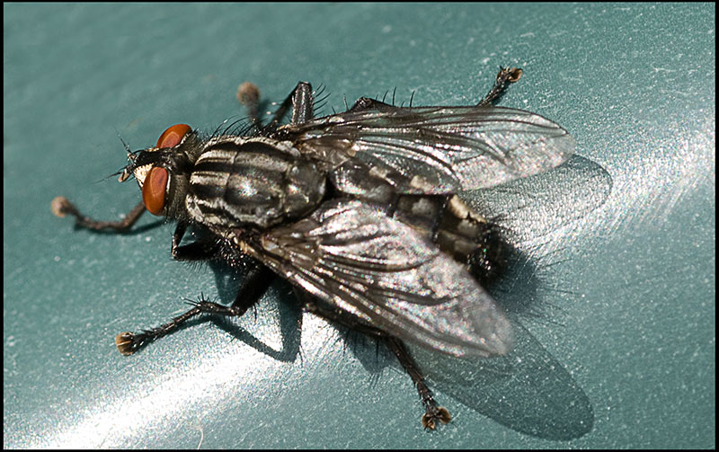

Really love that shoot what setting did you use? Aperture etc I am on a learning curve but once I get to know these details I am a quick going..
Also was that done in auto or Manual? As it seem nice sharp picture alot of the creature in focus
I used f11, 1/200sec, ISO 200, Manual Mode, Manual Focus, Flash.
I used the same settings for this one also.
were they taken outside in some good lights? Were they Cropped as i cant seem to get my item in the right DOF only seem to get a small part in focus
Also what flash? onboard or ??
Mine was taken out of my window in a shaded area. It's not cropped. I'm not sure what camera you're using, but if you have live view function, try it. It really helps you learn how to focus better. On my 40D the 10x magnification is the best thing since sliced bread for getting accurate, you can use the toggle button to move the view to your required focus pint. For me anyway.
Other then that, I find the easiest way to use the lens is by extending it as far as it will go focus wise (bringing your subject close to you), then pull the sleeve back to lock. Then I approach my subject whilst looking through the viewfinder, and keep on approaching until my subject is in focus, not it's background. Moving your whole kit, instead of the focusing ring is much easier. Again, for me anyway :lol:
Both of mine were taken in good light. In order to get a reasonable depth of field I used f11. I used Manual exposure so that I could force an aperture of f11. the flash was used to ensure a high shutter speed for a moving insect. I did crop the photos to get rid of excess background. The flash was an onboard flash.

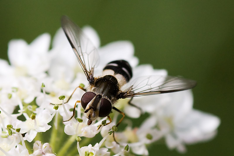

I use a combination of natural light and flash with my shots using this lens (note mine pre-dates digital so is really old, but still works a treat)
This was taken in sunlight without flash in Av mode set to f9
This one again in sunlight, but at f5.6, notice the shallow(er) DOF
This (and you'll have to believe me as the EXIF is stripped) was on Manual 1/200th, f8 with a 430ex on a cable at -1 1/2 stops
