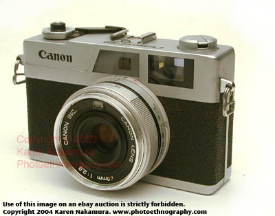

I have an old Canon that looks similar. A Canonet 28 to be precise. This may just be a foreign model of that. Does it have any numbers present?
Edit: Just noticed the second image and it does look a LOT older than my model. Hmm ... I'm not sure then.
