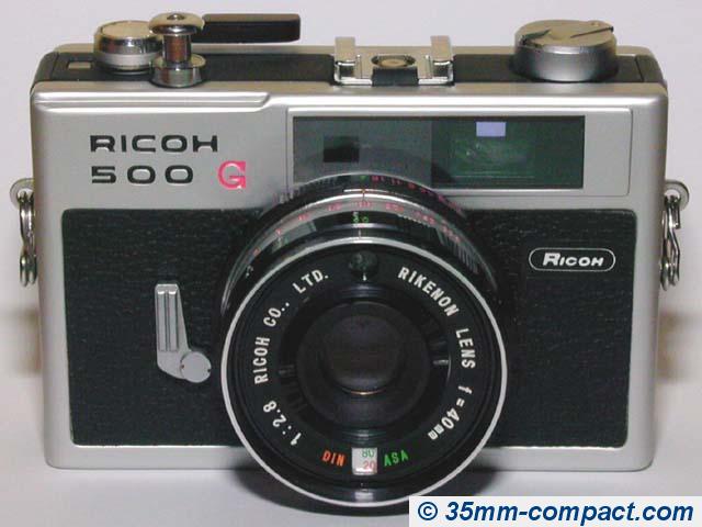

It's not quite as simple as "rangefinders meter through their lenses", period. For instance, a Leica M5/6 meters TTL, but a Yashica Electro 35 doesn't. Almost all the 1970s compact rangefinders don't meter through their lenses, but because the light sensor is often within the filter ring, it's almost like they meter TTL (for your purposes).
An example of that sensor is between the "LTD." and "RIKENON" on the lens:
