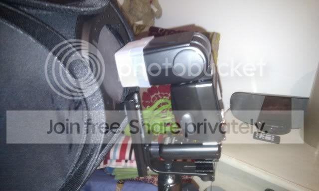

I have a FITP softbox and am using a Yongnuo RF-602 trigger to fire my SB-800, the problem comes when mounting the trigger to the bracket with the coldshoe, the trigger is hitting the bracket and the flash isn't going far enough into the softbox. Anyone any ideas, Can I attach a cable from the RF-602 to the SB-800 to trigger it? pic below is of current set-up. sorry for the poor pic..
Thanks
Adam
Simply mount the RF602 so that it faces away from the softbox and turn the head of the flash through 180 degrees - problem solved :D
Swivel the head 90degrees so that the menu is to the side. Then adjust the coldshoe as well.You will be able to slide the flash head further into the softbox as well

I would make sure the flash head is in side the softbox to avoid as much light leaking out as possible.

Unfortunately, some flashguns come with an angled 'body', (like most Canons), and this means that turned through 90 degrees the head is not firing straight into the box.
The solution is to use a flash that has a external firing port, such as a pc socket.

Does anyone know if you can buy a sync cable to link the RF-602 to the flash and then Velcro the receiver to the flash or hang it round the light stand?
Cheers, the RF-602 set I got from you came with a cable, will that work? or do I need the one above? using with a SB-800

You can just turn it through 180. Makes the controls hard to get at though.

Impossible to get at, I would say.
I have been using it turned through 90deg, but The flash head sits slighty too far out of the softbox.
