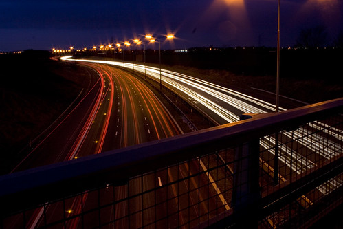

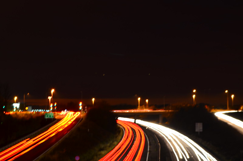

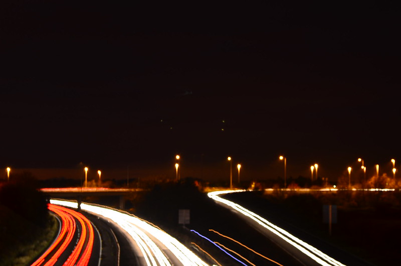

Got out just after sunset
First two are facing west towards M25 J6 Clacket Lane Services M25 and the 3rd photo facing east
IMG_0238 by Fla5h.Photos, on Flickr
Exposure 10
Aperture f/8.0
Focal Length 24 mm
ISO Speed 100
IMG_0232 by Fla5h.Photos, on Flickr
Exposure 15
Aperture f/8.0
Focal Length 24 mm
ISO Speed 100
IMG_0239 by Fla5h.Photos, on Flickr
Exposure 10
Aperture f/8.0
Focal Length 24 mm
ISO Speed 100
They look so much better for the nice colours in the sky :thumbs: I'd think that you would have been better off with a little smaller aperture say f/13 :thumbs: but the M25 is great for light trails by virtue of the amount of traffic :thumbs:

That's come out really well Joe, I'll have to add that location onto the light trail map :thumbs:
Leigh, it has to be the first for me the second is just to blotchy for me :( but I'm really not like the composition with the railing of the bridge in frame :(
Matt
Fair enough - I think it's probably one of those that split opinion, as i've also had people telling me they like it.
But then - if everyone agreed life would be dull ;)

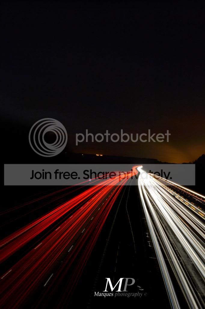

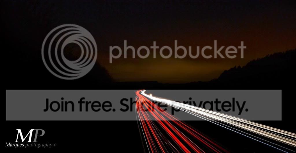

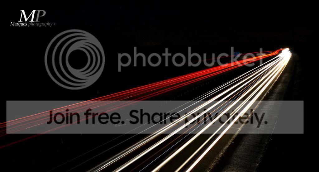

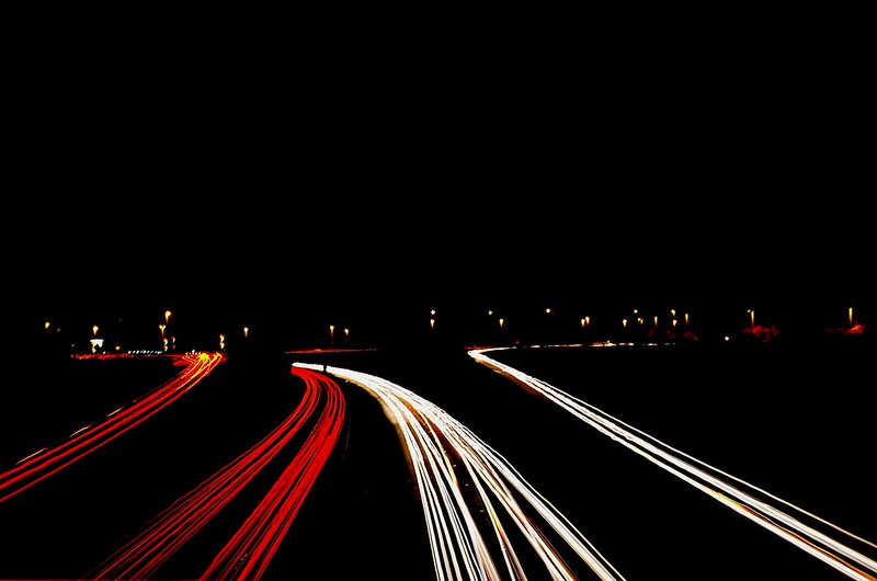

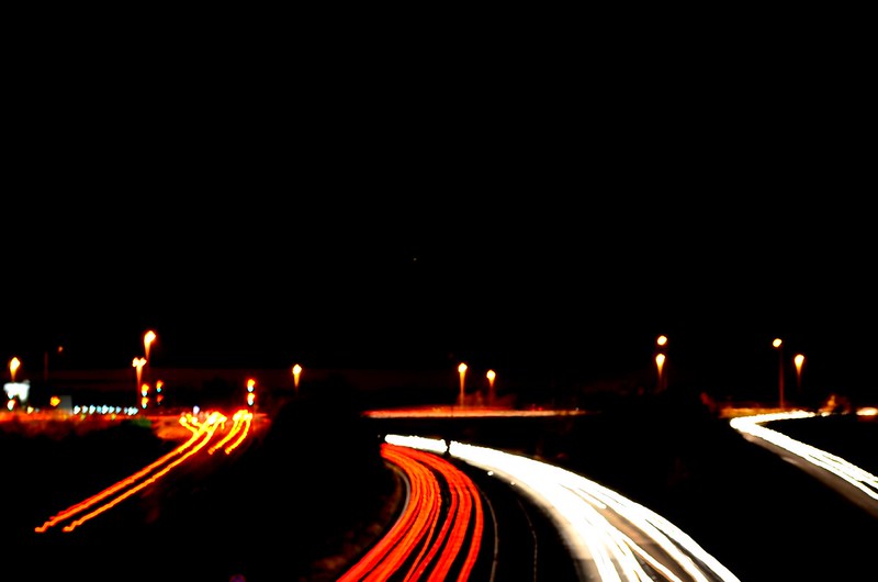

I read the tutorial for this and the other night i final got to do my first light trails :) The thing that botheres me about the shots i took were the noisey sky.
1.
2.
3.
Firstly there is no exif data available for these photos :( what I will say is that the file sizes are very small, what quality setting did you save these as, because there looks to be quite a bit of JPEG compression in them, to really improve these though you would be much better off getting to location a lot earlier so that there is still some ambient light, this would make a much more visually appealing light trail, the location looks great :thumbs:
Matt
Matt
Thanks for the feedback matt, i dont know why the exif isnt showing, it was shot at normal quality but saved as high quality. Shot at ISO 100, f22. I do agree with going a bit earlier to catch some light.
The location was in Banbury, theres a bridge by the crematorium.
I think I know the bridge, never shot from it but I'm sure I know it :D I'm not sure about the noise care to post a like to a full/original size version so I could take a look?
<snip>
Matt
Matthew,
Excuse my ignorance; but could you kindly point out what you see that tells you this is a JPEG with compression issues :shrug:
I'm not being pedantic, but for the life of me I'm not sure I can tell such details.
Thanks if advance :thumbs:
Wail said:
Matthrew,
No worries to me the sky especially in the first two looks a little on the blotchy side :shrug:

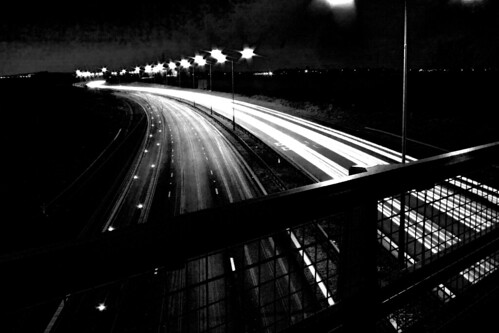

Been reading up on this and Matt's excellent advice and fancied a go - after all we have the lovely A14 :cool:
First one was -
DSC_0170 by zoomboxer, on Flickr
It looked great on the camera's viewer but was surprised to see that it was blurred when I put it on the PC - how do you manually focus in the dark? No cable/remote trigger so perhaps the actual fact of keeping the shutter button pressed for 30 seconds did not help either.
2nd one was:-
DSC_0171 by zoomboxer, on Flickr
Moved this a bit to the right but realised that it was too far and cut the left lane off
so tried again:-
DSC_0172 by zoomboxer, on Flickr
bit better I thought - now all 4 light trails are in - they were all taken at the max of 55mm
then thought "why not change to 18mm?"
DSC_0173 by zoomboxer, on Flickr
and seemed to do the trick.
By then I was attracting too much attention and baled out! They were taken on the Milton foot-bridge - thought this would be better and would not be bothered by passing traffic but a couple of guys on push-bikes did pass by a bit too slow for comfort so legged it before they came back :D.
Hi Steve, glad that I've inspired you to get out and have a go :thumbs: you would do better to get out there earlier to get nice colour in the sky :thumbs: what I would say is the trails are a little on the wobbly side, now the fact that you were on a foot bridge makes me wonder if this is not the cause as there tends to be a little movement in foot bridges, more so that you would get form a car/traffic bridge, the focus also looks a little out, thought this will have been extenuated by the camera movement mentioned above :shrug: I take it that you were using a trigger, if not then this will likely be the main cause of the movement
Matt
Matt thanks for the advice. No trigger used, I did look in Jessops but they want 18 quid :eek: I know I can get it off Amazon for half the price or less. Plan was to get there a bit earlier to get some sky but got held up-next time perhaps. The bridge is half foot and half cycle path and is lit perhaps that and the fact that no trigger was used could point to out of focus but how does one get the focus right when subject is dark?
This location you should have been able to auto focus on the street lights in the distance :thumbs: though often I'll use AF to lock onto some car headlights :) then go to MF :thumbs:

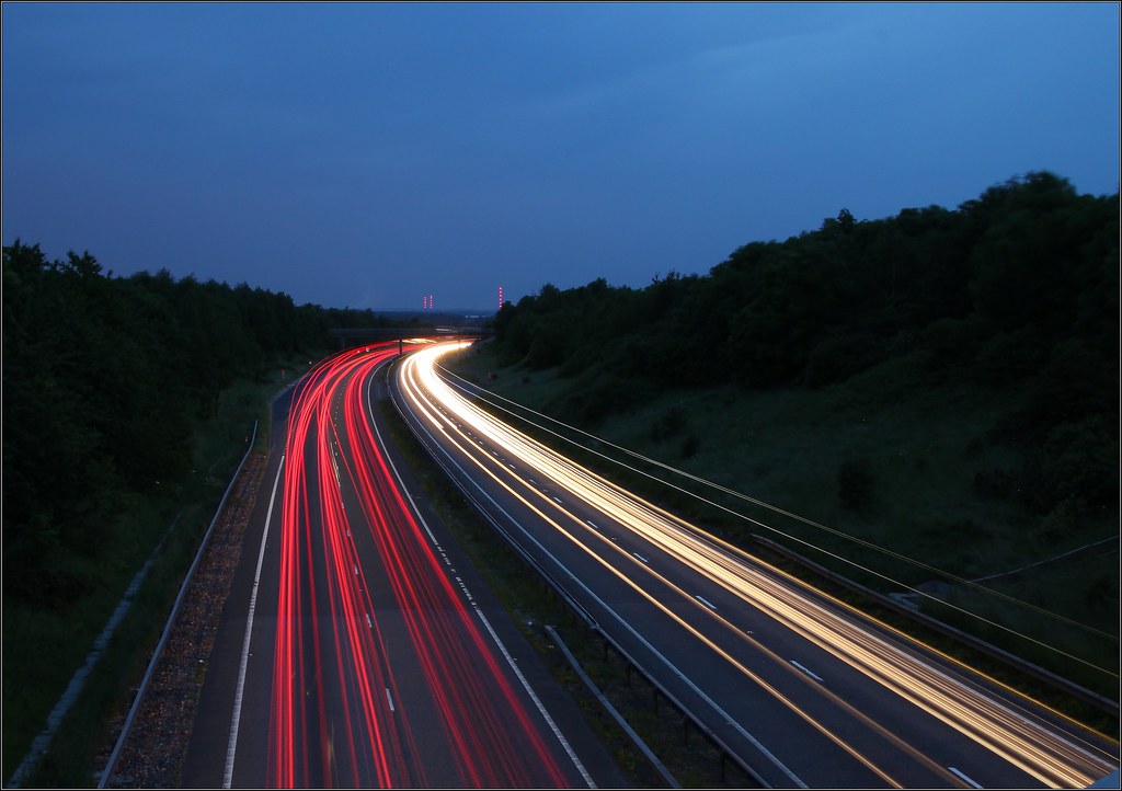

CollisionKisses said:

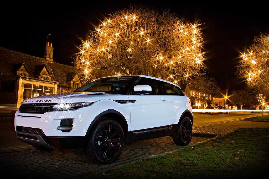

How do I take photos of stationary lights to make them look almost starry? Like this ...
http://digital-photography-school.com/wp-content/uploads/2008/01/light-trails-1-1.jpg
Using a smaller aperture and a long exposure will get you some nice stars like that anything from about f/11-13 and up an example would be this that I should around Christmas time last year
Land Rover / Ranger Rover Evoque / Broadway / 2011 by mwhcvt, on Flickr
This was shot at f/22 the get quite extreme stars in the trees from the Christmas lights that were in there, and was shot over a 99 second exposure
I hope this helps and welcome to TP :wave:
