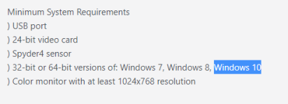

I've come across my first problem. I use a Spyder 4 Pro to calibrate my monitor. My new PC has no DVD/CD drive so I downloaded a driver from the Datacolor website. After some head scratching, I think I have to admit defeat as it doesn't seem to be compatible with Windows 10.
That's a proper blow, I've maxed the budget.....and some, I can't really afford a calibration tool for a while yet.

It says here that Windows 10 is compatible?
