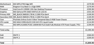

I've just gone back and added up what I spent on mine - I added a couple of extra bits not originally planned - and came in a bit more than expected (Initially planned to spend just over £1k - but kept justifying why it would be better to get this or that). I thought I'd add to the thread with a few details as others might be contemplating buying a new setup.
My old PC was also ancient - but still sold it for £200, and also had my dad's old PC that went for £360 - so that brought my outlay down a bit. I probably have gone overboard a little on the spec and the budget - but I want it to last at least 10 years like my old one did. I want it to handle today's apps and programs, and where possible those in a few years time too. (I did the same last time, which I think is why I managed to sell it for £200 after over a decade, and it was still doing ok considering).
I've never been a gamer - mostly played a few sims - but have tried my first 'proper' game with this setup, and I'm quite blown away. It involves running around streets and buildings shooting up baddies that appear to get bigger and stronger as the levels progress, but has (for me) some top notch graphics. I've managed to progress quite well for someone that hadn't played a point and shoot before. I can see me playing the odd new game as it comes along of this genre. (Tom Clancy's The Division 2 - where the PC LED's change colour with the game actions - so engage with baddies and the PC turns red! I'm not easily impressed, honest :clap:)
I'm also going to be (not yet) running a fairly hefty flight simulator on it - so will be interested to see how it handles that.
I originally only had the 1tb PCIE SSD - and wanted to pop my games on this alongside the operating system to take advantage of the speed of access, as I had a stack of old HDD's for storage that are also fitted that didn't need speedy access for my photos. It filled up far too quickly though, so have added another 2tb PCIE SSD, and that's now about half full with a stack of games - and won't be used for anything else. I do like the way the SSD's are inserted into the motherboard itself. My existing HDD's mounted to the side look huge in comparison.
I have to say it's very quick. My lightroom and photoshop do everything I want at a decent speed.
Aside from the prices - they do add up quickly - I have no regrets :) It hasn't crashed yet!
