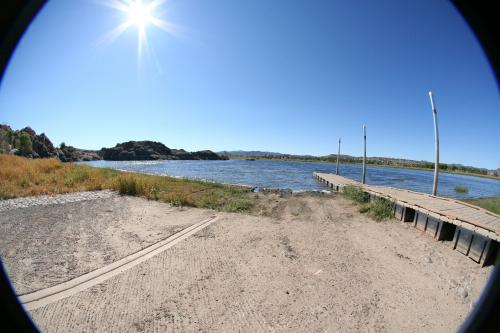

Could someone advise how useful I would find either of these two lenses for a panoramic shot? The camera I have is a Canon 400D
Last year I took many shots with the Canon EF28-135mm f/3.5-5.6 IS USM, trying to recreate a stichable scene into a panoramic.
A couple of them were usable, but many weren't.
So I was wondering, about the following two lenses, whether overall it would be easier to use a lens like these and crop/stretch it to a panoramic.
Can't find any example photos from the 4.5mm, and only a couple from the 8 which were probably taken on a 1.6x camera sensor.
Sigma/C 4.5mm f/2.8 EX DC HSM Circular Fisheye
Sigma/C 8mm f/3.5 EX DG Circular Fisheye

Anyway, you really don't want any sort of fisheye lens to do panoramas. Your 28-135 should be fine.

Fisheye lenses are only good if you want to get 360x180 panoramas (e.g. HERE) in a small number of shots. These can be done using 200mm lenses but require many hundreds of shots. For these panoramas you really need to be rotating the camera around the nodal point of the lens using a special panoramic tripod head.
There is no real difference between this type and the type you have shown, I suspect the problem you have is the method of stitching you are using. I don't know how CS2 does it but it looks like it is having problems blending (and joining) the shots together perhaps you could give PTGui a try.

The lens your asking about will make things much worse, the distortion on those will make the blending very difficult, the len you have should work fine, try coming off the 28mm end slightly (that should help the vingette a little) and work left to right, it shouldn't make a difference but it seems to on occasions, overlap a fair bit, I overlap at least a third, usually more. Wayne
