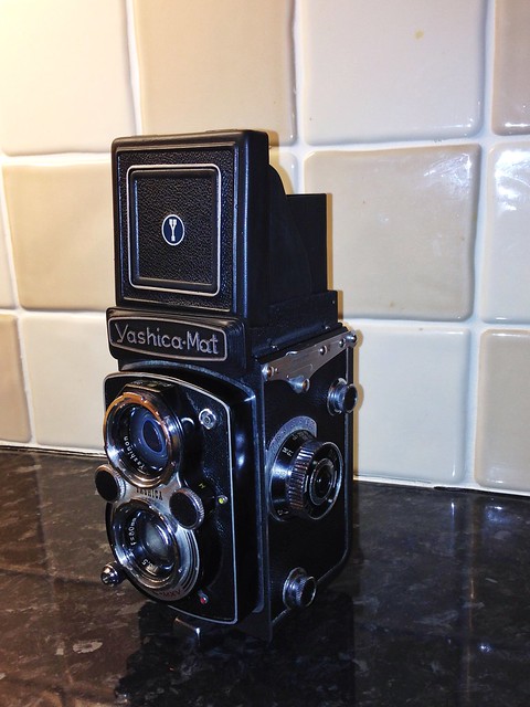

I've just added a Yashica Mat to my ever changing film collection. It's actually in good condition apart from it missing the front leatherette covering (good excuse for a full re-cover!) and needing a general clean as it doesn't look like it's been used for a while.
I'm going to give this a bit of a cleanup as well as a new skin then will probably flock the film chamber before I put a roll of film through it. I'll put some shots up once I have.

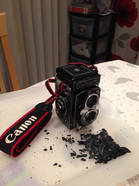

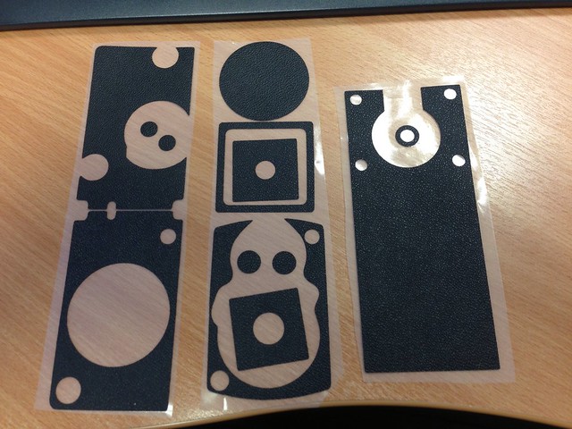

Yay, my kit from CameraLeathers has arrived so once I get the last section of old leatherette off the Yashica I'll be fitting this shiny new one :0)
All forum posts about getting the old covering off are definitely true...that stuff is welded on!

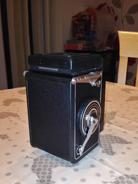

I've just finished the Yashica Mat refurb and must say that the cameraleather kit was spot on and surprisingly easy to apply so definitely recommended. I decided to sand back the external black paintwork and use flat black enamel paint to finish. The benefit of the enamel paint is that it can be brushed on in thin coats (3 in the end) but dries smooth so there was no need for a complete strip down to spray it.
Finished Yashica Mat by Steve Lloyd, on Flickr

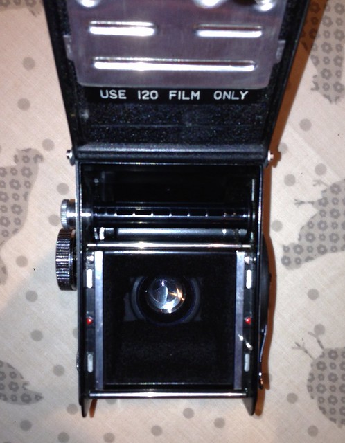

I also flocked the film chamber a few weeks ago;
Not the greatest pictures so I'll take some better ones in the daylight. I ran a roll of Provia 100 through the Mat a few days ago and it's at AG now so I'm really looking forward to the results :0)
