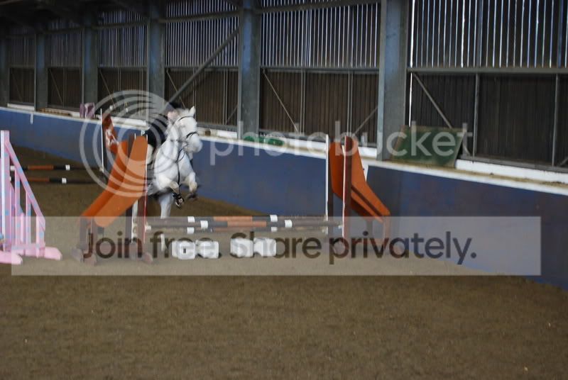

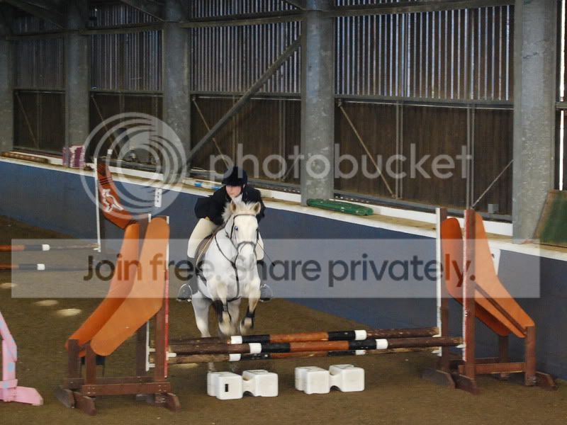

I went to a show at the weekend and even with the flash the pictures indoors were a little blurry..I figured it was just because it was rather dark, but it did occur to me that my friends Cannon EOD 400 could take lovely photos in a darker arena than this one.

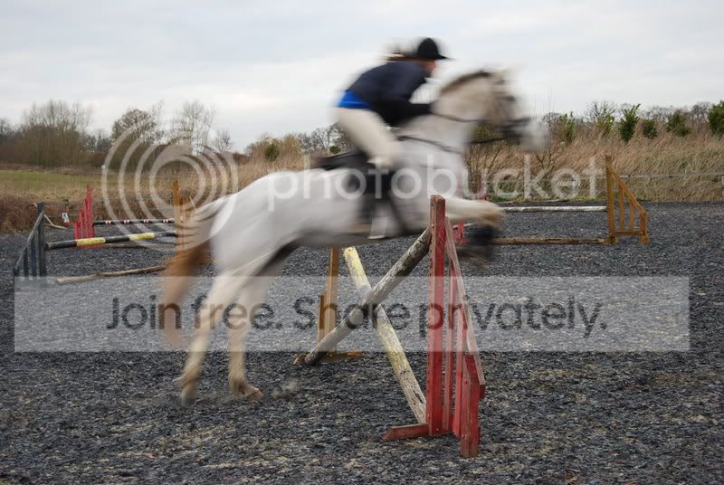

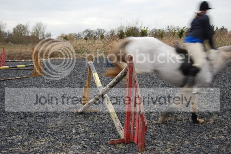

But then today, my mum took some photos of me jumping my horse. It was quite cloudly, but not particarily dark, but ALL of them came out really blurry. The settings were all on auto as I'm not very experienced with cameras, and most of the photos were taken with the click-click-click sort of format..
They all came out like this

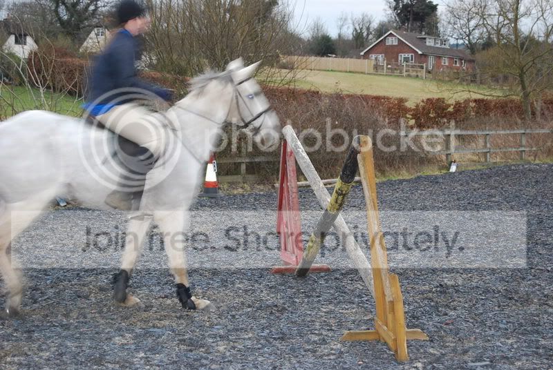

Here was one which she didn't take in the click click click way
It didn't want a flash until later, when it came out like this.

It looks like you need a faster shutter speed than you have been using. If you have the camera set to Auto, it will adjust the shutter speed to get the correct exposure for the light available, but will not detect that you are shooting a moving object. Does the camera have a pre-set sports mode for you to use?
The shutter speed is fairly slow on these, also it looks like they were not 'panned' so a blurry subject is almost inevitable.
A faster shutter and some panning could help.

You need to set the camera up with Shutter priority selected and then set the shutter speed to about 1/250th or faster if the light allows. The camera will then use this shutter speed and set the aperture accordingly.
You may need to set a faster ISO as well particularly if the light's poor. And don't forget to pan with the subject
Just looked at the EXIF information on one of the pictures you mother took. The Shutter speed was 1/50 at f4.8 with an ISO of 200. You'll probably need to go to ISO 800-1000 to get that 1/250 shutter speed on days like this
