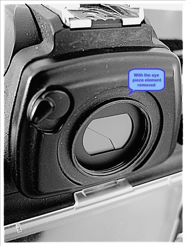

- Have a speck of dust in viewfinder, no evidence of this in images, even taking a pic of the white wall, and when i close the viewfinder shutter/curtain you cant see it, so seems to be around there. Any way to get rid of this?

I have taken them of using a credit card sliding it underneath and then using meths to get resudue of, make sure you dont crack the glass on the ggs else it will scratch the lcd i have done this before and thats why i hate them, acmaxx are the best.Cheers Scott, didnt realise the piece came off, dust all gone now!
