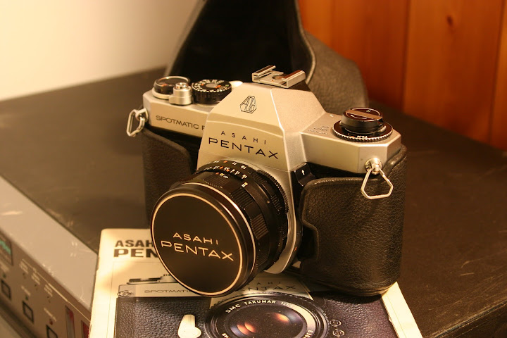

anyway, my old Spotmatic F

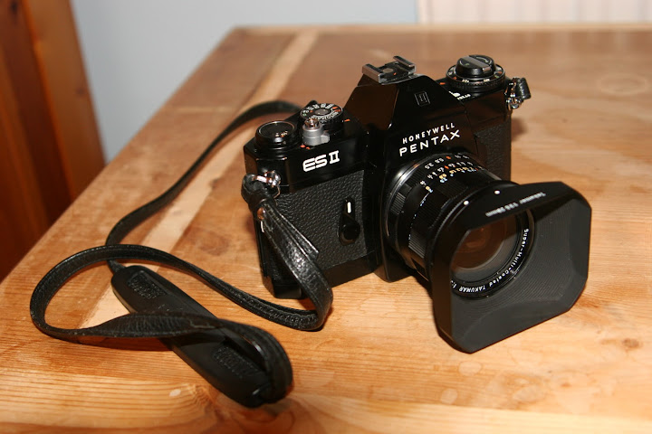

And current Pentax ESII, basically a Spotmatic F with Av mode:
