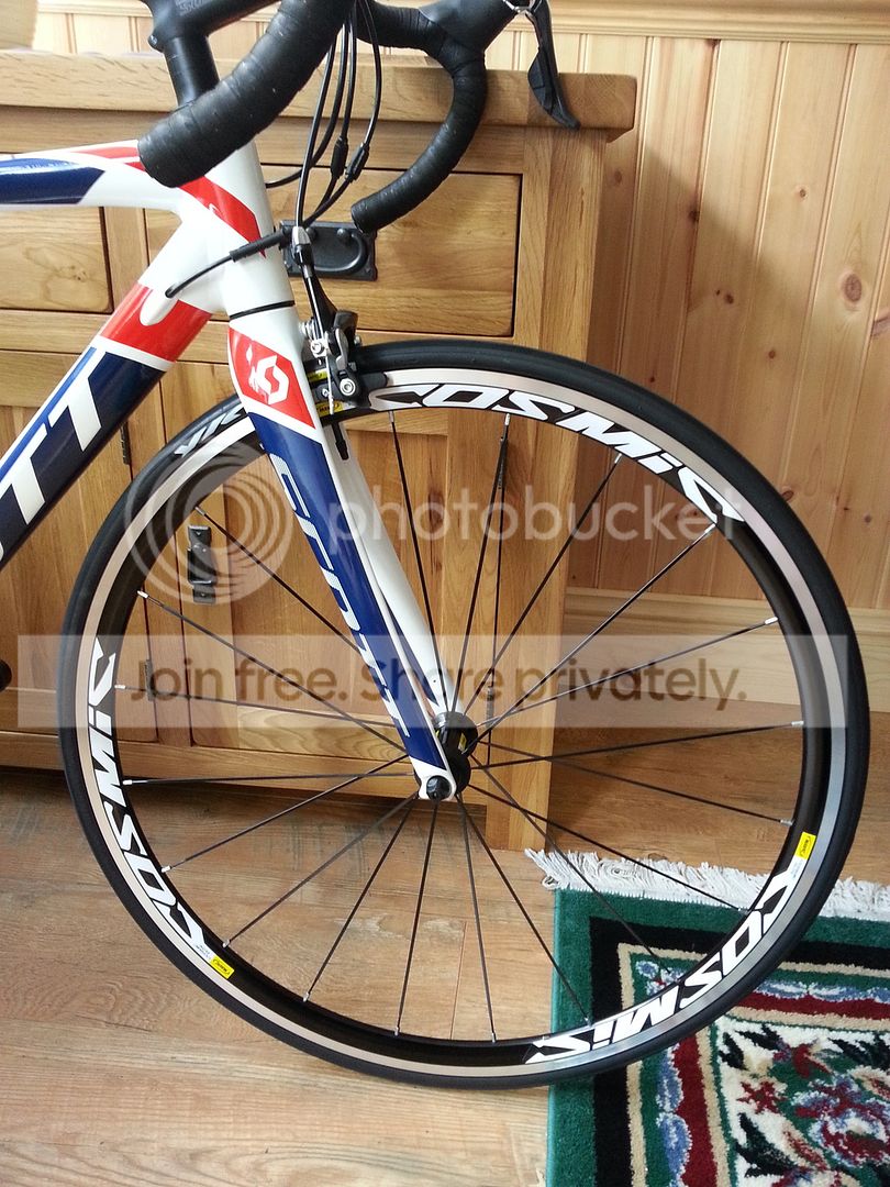

I do have a road bike as well, a scott speedster 10 with some mavic cosmics but that lives in Huddersfield at the family home. At the moment I am working in Erskine near Glasgow so the MTB is doing service up here hence fitting some slix and maybe changing the forks just to bring it closer to my road speeder.
