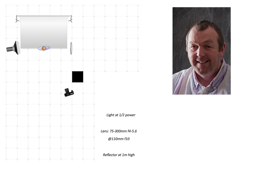

So we set up again today and moved a few bits and pieces around. tried to take into account the things that people here said, and also have a go at something with a little more "modelling" light etc.
This was one of the results. We have a main light above the camera left shoulder giving the broad light on the face. We have a light behind the subject giving a hair/rim light. And a reflector camera right giving fill to the model's left face.
Hopefully there is a little more definition here, a little more shape to the face and the shadows. We moved the lights around, set to 1/2 or full, metered and set apertures, etc. All to get a balance. Did we achieve it? Let me know what you think.
31-3-2012 Tim at Studio Broad and Rim by http://bendthelight.me.uk, on Flickr
That's actually more of a backlight that a rimlight, a rimlight really comes more from the side/back than from the back.
But what an improvement over the shots you posted just a couple of days ago! Part of that improvement is down to getting rid of the white background, part of it is just thinking about where the light needs to be, instead of just flooding the subject with light.
But IMO you've used far too much fill - just try again with the reflector further away. Sometimes fill isn't needed at all, sometimes just a touch is needed.
Thanks. I was following direction from a lighting website, and they called it rim light. They could be wrong of course. Besides what it is called, I was pleased with the effect.
With the reflector, I was concious in a lot of test shots that the eye was VERY much in shadow, and so we used the reflector for that...maybe a SMALLER reflector just to lift the eye a little, but not hide all the shadows?
Thanks for your time...we are determined to do well with this, so all feedback is vital...and you see that we do take notice and try to use it to make things better. :)
There isn't necessarily anything wrong with shadow, so don't think that it always needs to be 'corrected'. Photographers are judges by the shadows they create, except on a very dull, overcast day, shadows are all around us - and the contrast between say bright sunlight and shadow cheers us up and makes everything look much more attractive and interesting...
We use small reflectors (and sometimes they are VERY small) in still life photography all the time, but they aren't a very good idea for subjects that don't keep still. It's usually better just to move the reflector further away from the subject, just moving it a bit further away will reduce the effect dramatically. Actually though I do it the opposite way round, I start with it a long way away and then move it gradually closer until it has the effect I'm looking for.
These lighting websites are all very well, but just try the suggestions I made in your other thread, nail those techniques first and then try doing more complicated things.

Looks like a rim light to me too Garry - a backlight would give a different effect. For me I think the main issue is the main light is too low and that wee chink of light on his cheek catches the eye.
I think that you'll find that it's a backlight - probably a hotshoe flash hidden behind the head - but let's not split hairs:lol:

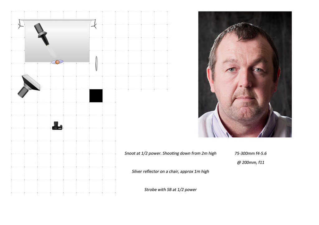

So, I tried again with the rim light (and this is not a back light)...this time I went with quite a broad main light (although i can see that had I brought it round to the side a little more, it would have been more of a short light). I snooted the other light and directed it at the hair. I see that the rim effect is only on that side of the head now (as opposed to all around in the backlit version).
But anyway, what do you think? By the way, the diagram is accurate, the squares are 1/2m each.
Andy with snooted rim light by http://bendthelight.me.uk, on Flickr
Let me know what you think (I know you will!). And I will try going back to a single light next time. :)
I think what I was getting at in the photo above was a light around the edge of the hair, and I can see this as a backlight.
It's a RIM light. You can see the rim.
But it was described as a rim light in one article I read, and I used their diagram to set it up...I can also see that a rim light could be like Garry's second post, where one side, well, actually less than the side, just the rim, is lit. I'm a novice, so I go with whatever people are calling them! :)
I see the rim in Garry's shot too.
This is a rim light just more controlled as a hair light. Actually I'd describe it more as a back light.
