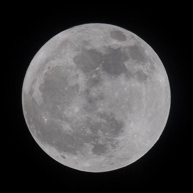

Here's an uncropped shot at 840mm on a 7D.
