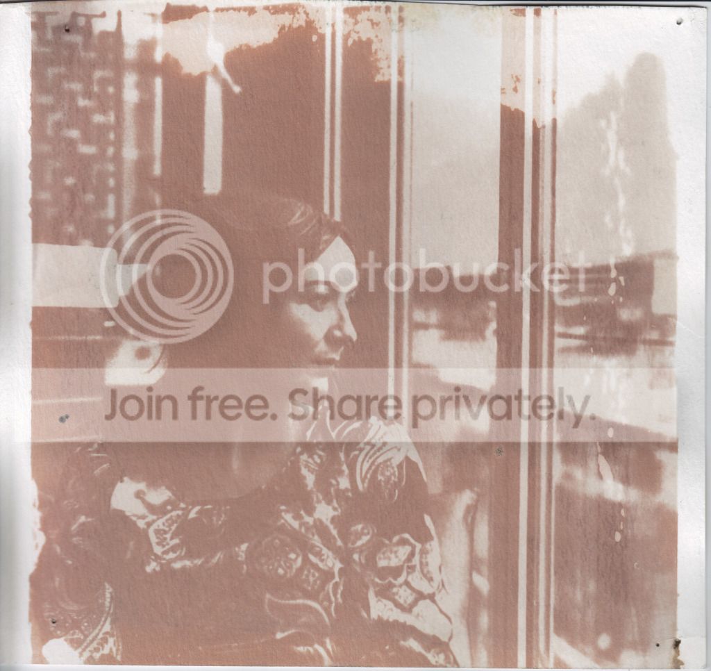

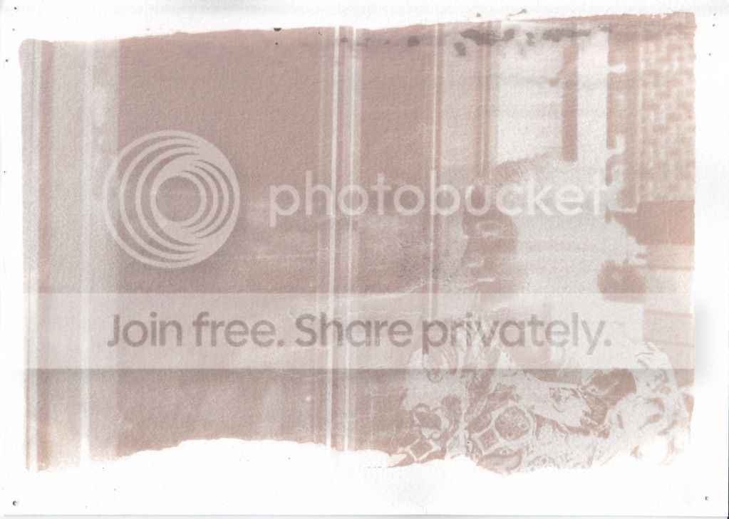

I then had plenty of time and itchy feet for a contact print so decided to try a bit of salt paper printing, so i mixed up a solution of 100ml distilled water to 20grams of ammonium chloride and rod coated a piece of water colour paper. Damm that stuffs expensive! (edit...i then coated the dry salted paper with the silver nitrate solution)
While that was drying i made my transparency, but as i have been making anthotype prints that bleach out under a positive i went ahead and printed a positive lol
Its a negative required for salt prints! ho hum good practice. Made a negative transparency and a print from that i might post but be gentle.
