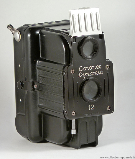

Well I learn't the disadvantage of a cheap TLR when I was about 14....the view showed the head but the film didn't o_O
..and a fixed lens :eek:
