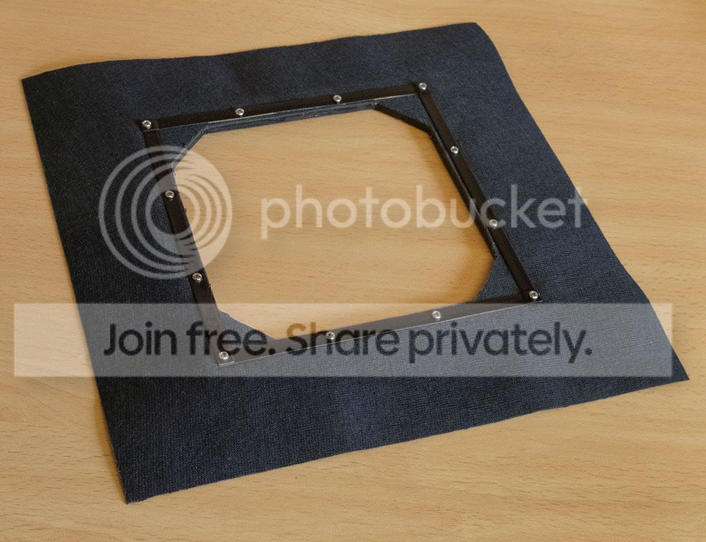

I have just completed making a bag bellows for my renovated MPP monorail.
As I did not have spare bellows frames I had to make my own out of Ash to match the standard square bellows.

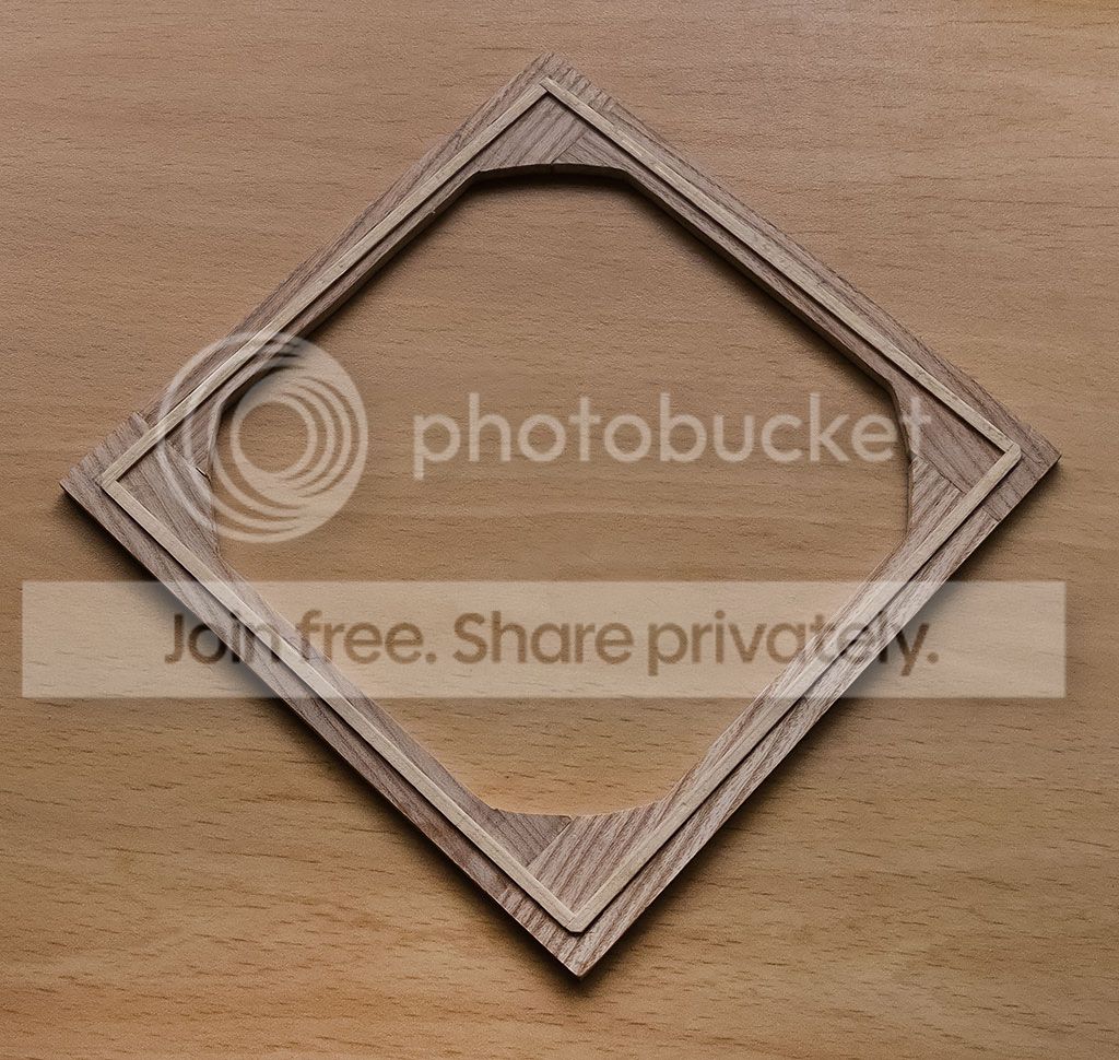

  1. Outer view of frame showing construction from two layers of laminated 1.8mm x 24mm ash, with relieved areas for the locking slides. The inner shape was cut out after completion.
  2. Inner view showing added light trap

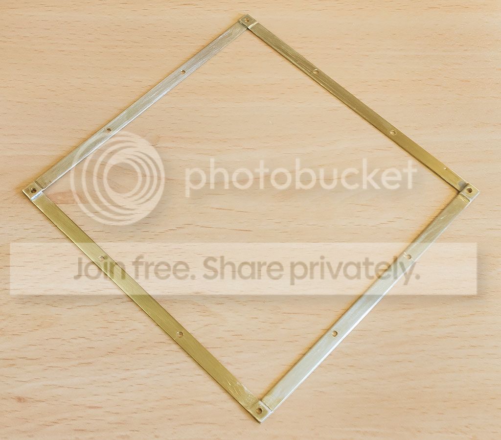

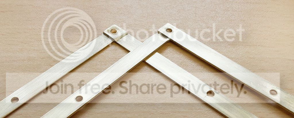

  3. Retainer made from 6mm x 0.8mm brass strip.
    bb3.jpg~original

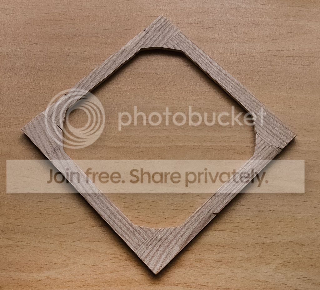

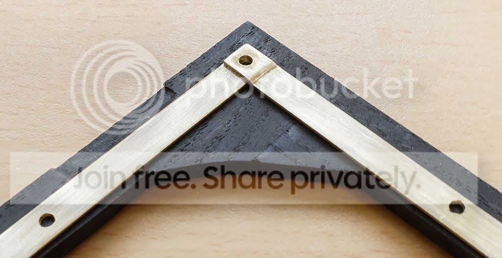

  4. Detail of corner relief. To ensure flat holding surface to hold vinyl. And screw holes.
  5. Detail of position of retainer on painted frame.

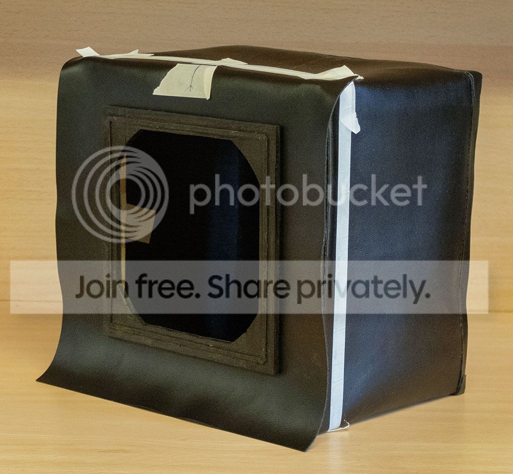

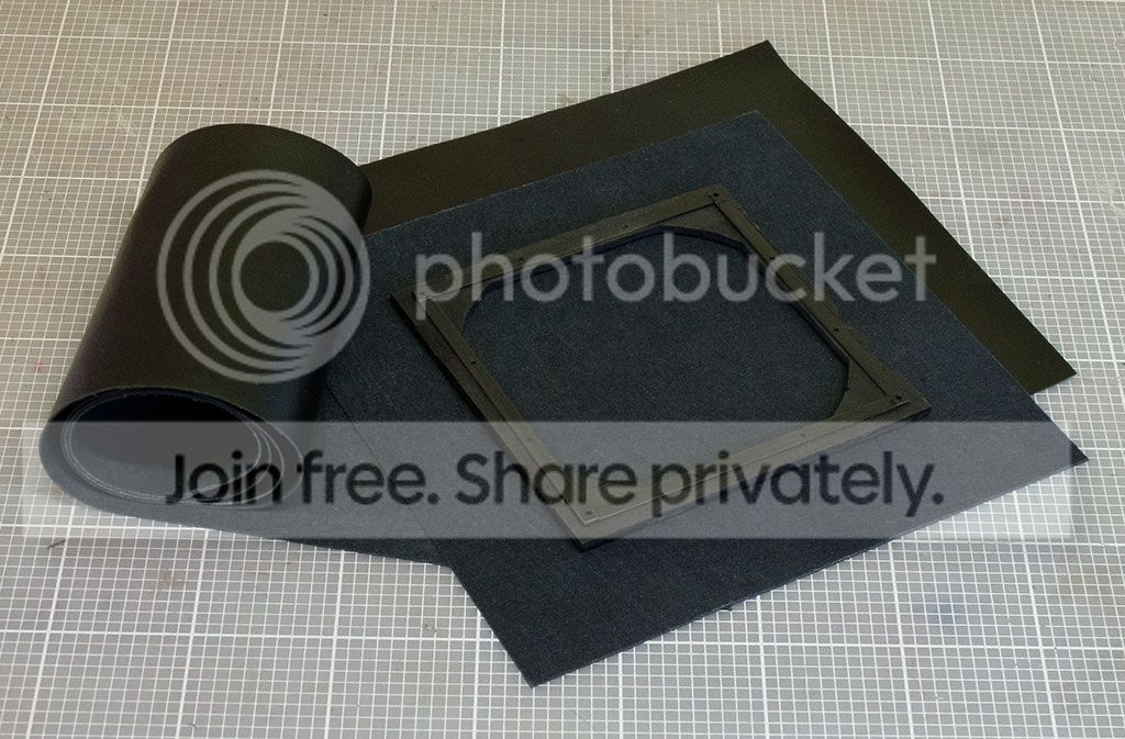

  6. Cut Vinyl/PVC sheets ready for glueing assembly.

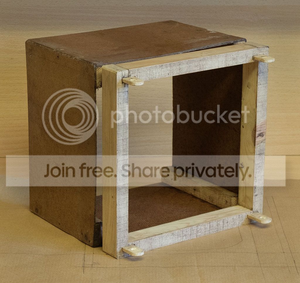

  7. Glueing frames. The larger frame was used to glue and fix the the first end. The smaller second frame was constructed so as to be removable from inside the finished bag after fixing the second end.
Continued.......
  1. End assembled and ready for for glueing up.
  2. Final stages of glueing. Masking tape was used for positioning and for taping joints.
    PVA glue was used. This proved to make a stronger joint than the material. However it was necessary to etch/clean the pvc, first with Acetone then with meths. to ensure the glue fully wetted the plastic surface. (neither when used alone achieved a full adhesion)

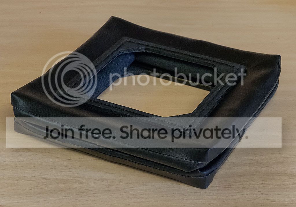

  3. Finished and folded bag.

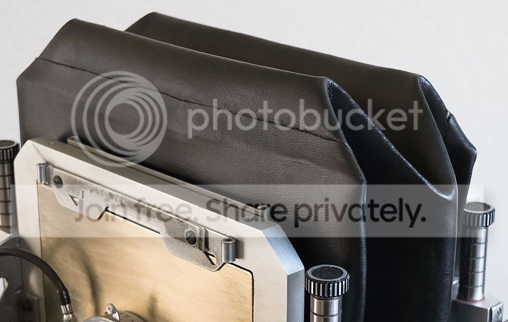

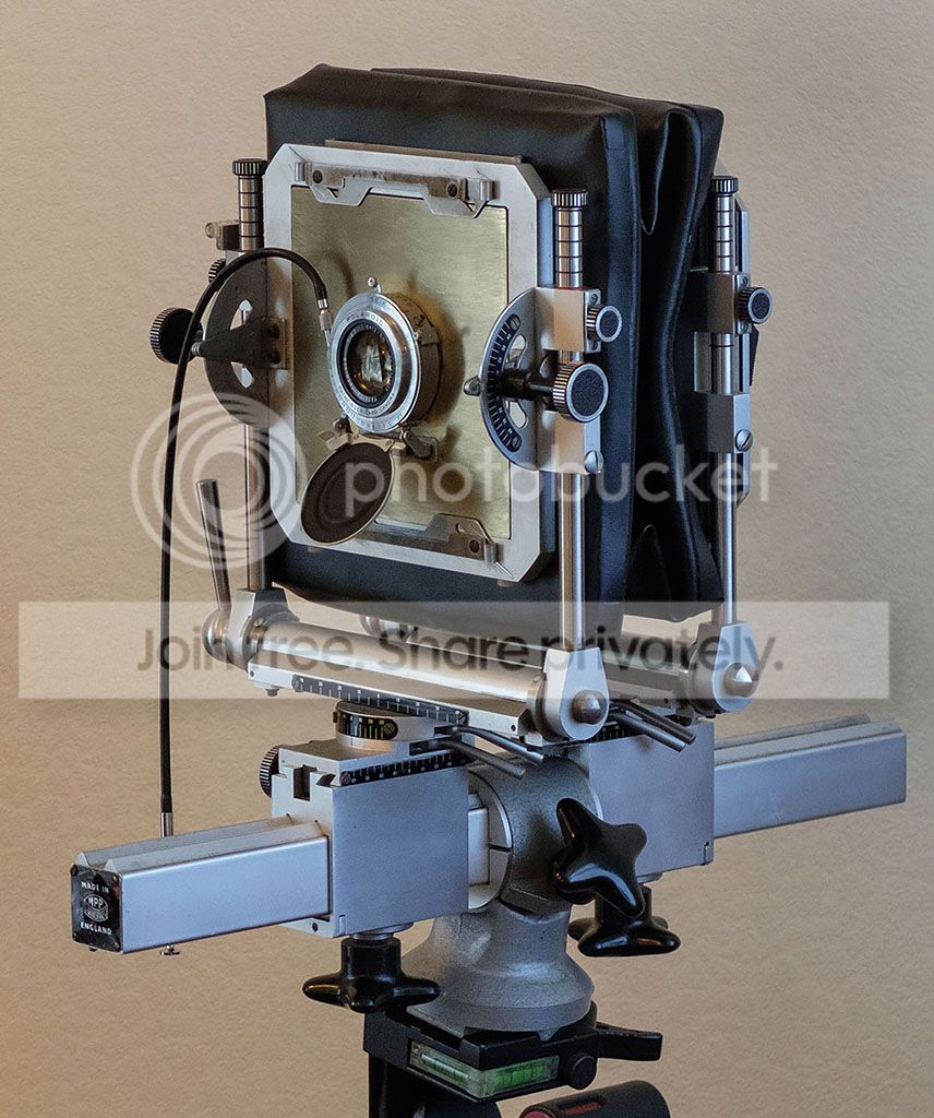

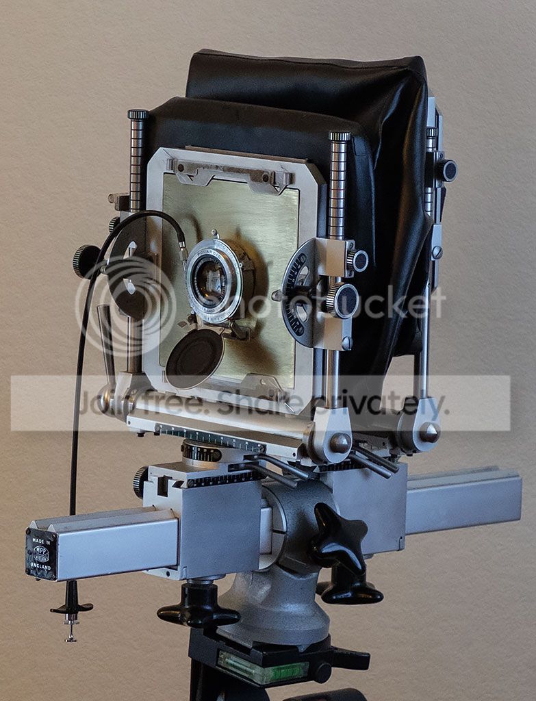

  4. Attached to the camera in neutral position.
  5. Full front fall and back rise.
I also made the brass lens board to mount the Yashinon 127mm 4.7 lens and lens cover scavenged from a Polaroid 220 camera. I will use this in combination with a Graphic (singer) 120 film back.
MPP monorail lens-boards have a 2mm return lip, I created this by soldering a 2x2mm brass strip around the inside of the the 2mm plate. The back of the board has been finished matt black.

As bag bellows have no card inserts in the folds, like standard bellows, the folding style is entirely optional and does not constrain them in use. however how you do it can help to avoid obstructions in the light path. This is an alternative I have settled on, as it reduces that possibility when using little extension.
