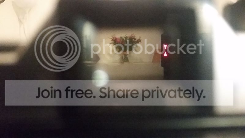

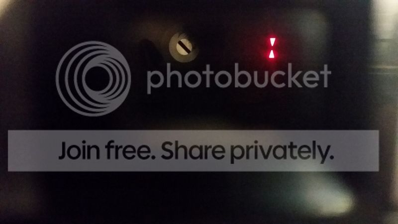

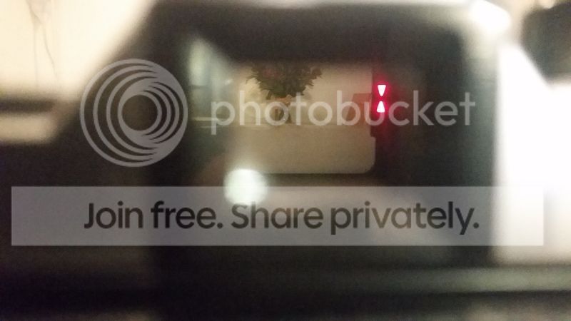

Yes it is stop down metering, which I THINK understand. I took a few pictures on my phone looking through the viewfinder with the light meter activated
F16 @ 1/250th (taken indoor should be reading under exposed)
F16 @ 1/30th
F1.8 @ 1/5th
So when you took the above vf images to show the meter indicators, you were pressing the stop-down lever on the camera body by the lens mount?
Yes the black lever which activates the light meter.

Hi Steven, on the basis of your viewfinder images, I would say the meter is probably shot. These were East German budget cameras and time can take its toll on them . That said if the rest of the camera works I would use with a hand held meter. I prefer these to a phone app, but that is a personal preference. Even with Matrix Meter cameras I still prefer to incident meter with a hand held, strange I know, but true!
