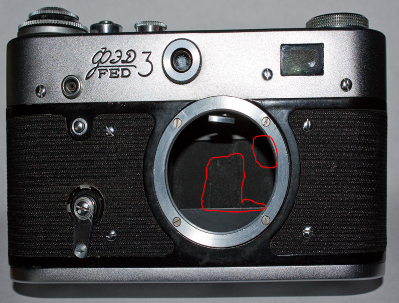

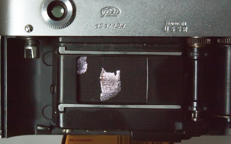

Have a look at this. It is MF camera but shutter curtain seems similar construction (rubberised fabric).
