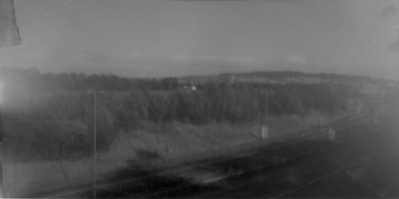

... or do I have other problems?
I've been meditating (not really) on my Hooley'd shot yesterday and trying to decide if its just seriously over exposed and I'm miscalculating my reciprocal adjustment, the meter reading is bad in the first place or if I've got other problems.

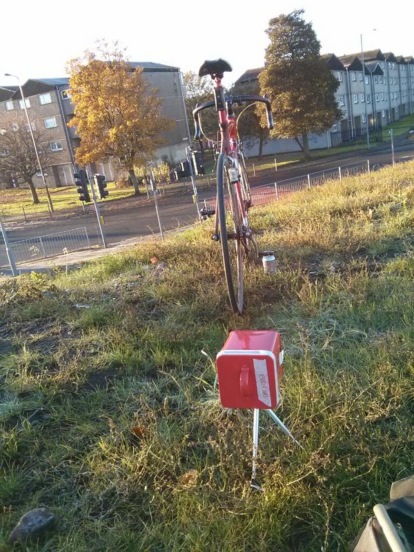

The camera is a coffee tin with a hole in the end, the pinhole is cut into a bit of coke can and taped to the bottom and the film is secured to the lid, so far so standard. I've not had a chance to paint the inside black yet, tbh I can't be bother to strip it and repaint as I don't think spray paint will stick to the current finish.
(ignore the artefacts etc the jpg has compressed really badly! I'll get a better copy later but you get the idea)
2013-10-apx400-om30047-jpg.539
Is this a scan of a negative or are you using reversal paper in the camera?
My first thought is it is massively underexposed, but what was the subject? Was it a night scene? What should be there?
David
foggy ? ( not the weather )
This is scene. My meter read F8 - 1/15 and according to my calculations thats about a minute at F230, add in recipirical failure and we're about 6 minutes. From what I've read FP4+ is t^1.48 and GP3, apparently, responds in a similar manner.
I was worried I'd fogged it but I'm not sure how as I was very careful loading it in the bag. There was a little bit sticking out the tin but I doubt that would cause the whole frame to fog.
My calculator says that your exposure time should have been 7 mins.
So not over exposed then? Well assuming the meter was reading correctly. 1 minute at that lenght of exposure wouldn't have made such a difference, would it?
It would be easier to judge the negative if you took a picture of it against a light table ( or a computer monitor set to a white screen) and included some of the screen around the negative. For reducing reflection inside the tin I often use black craft paper and double sided tape to line the inside.
looks to be a recipricol issue to me steveo.

if you metered incorectly by a stop and needed nearer 2 mins as against one then with recipricol failure, you would be looking in the region of 17 minutes exposure!!
Much as one minute with a long exposure may make little difference, I'm pretty sure 11 mins will.
I realise this info is based for moonlit photography but as far as i'm aware the recipricol adjustment will be the same for the film regardless of the source of light.
Yikes! Yeah that might be the issue. Looks like that was the last time I'll get a chance to shoot it for the next few days but next time I'll take a better meter and a copy of a recipricol chart and hopefully make a better negative!
One more thing though, the negative is virtually black, wouldn't that mean it was overexposed?
Yes a black neg equates to overexposure......getrs more confusing dunnit?:confused::D
It could well be a mixture of more than one issue Steveo.
Perhaps look at lining the tin as David suggests to reduce reflection and re assess the metering/ recipricol adjustment .

Have you considered duffing the development up?
- If the negative is black then yes it is overexposed/overdeveloped/fogged - your pinhole may be bigger than you thought / check your dev concentration, temperature, time/ black out inside of tin. It is hard to tell things from scans of negatives as the scanner tries to adjust things - hence why taking a photo of neg against an white light source helps. One thought did you use a normal scanner or one for film that shines light through the negative?
Go for it my man..... Practice practice practice, go round in circles, collapse in a stuper, then give up.:lol:
Good luck :thumbs:
It might have been easier to start with a modifed roll film camera rather than a coffee tin but where is fun in that!
Not on purpose do you think it would help :D.
That might be a good shout actually, my rodinal was starting to look a little like overbrewed tea so maybe time to open the new bottle.
Good adivce, I'm pretty confident on the pinhole size as I had some micro drills which I used as a guage. There isn't much to see on the negative, it needs to be held up to a halogen to see the image. Yup scanned with my trusty V500.
Tired Rodinal would tend to underdevelop - my homemade Parodinol (headache tablets, drain cleaner and wine bottle steriliser) is two years old and looks like builders tea but still going strong. I would tend to look at trying to measure the actual size of your pin hole as a first step - got access to a microscope ?
No microscope but I could scan it and measure in photoshop.
Its theorectially between 0.45 and 0.5 mm as the .45 bit will fit through but the .5mm will not even if it is as much as 0.55mm then it would only be 1:30 over exposed which is only 25% over and I wouldn't expect it to be this extreme.
Oh and Parodinol? Sounds interesting.
What's the focal lenght of your camera?
Looking at http://www.mrpinhole.com/calcpinh.php and makiing some guestimates for the size of your tin - f230 not far out. But scene photo looks like a f/11 at 1/60th for 125ISO which is a good 3 stops brighter than you metered (if conditions were the same) so base exposure time on 13 seconds rather than a minute - that would give a much shorter time than 6 mins allowing for reciprocity failure - http://pinholery-blog.zonev.de/?p=72 has some numbers for GP3 reciprocity and a formula - I work that out to 42 seconds e^(1.46*ln(13)+0)
Sheesh thats enough maths before lunch for me. Good luck
I based exposure time on three stops below Sunny 16 from Pinhole calculator which gives 1.65 seconds at f/230 so 8*1.65 = 13 ish but should only have been two stops - duh 7.5 seconds - so 18 seconds by formula
Reciprocity gives me a head ache! Looks like I'll need to use the good meter next time. Thanks David, so really was just grossly over exposed.
I'll make the other adjustments suggested and load her up and hope for a bit of sun one lunch time and try again. God help me when I try these ancient glass plates.
The Pinhole designer program that can be downloaded from here http://www.pinhole.cz/en/pinholedesigner/ will do all the exposure calculations for you, for most of the well known films.
If we accept that you are 2 stops out in your initial exposure reading then for FP4+ the calculator gives an adjusted exposure time of 47s.
Yeah thats what I've got from my calculations, 5 full minutes is a hell of an overexposure.
