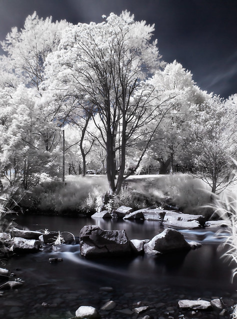

I had a dabble in the summer... when the light is very harsh for normal photography, it's perfect for IR.
My first attempt below on my Nikon D40X with a Hoya R72, 30 seconds at f8 ISO100. Taken mid afternoon on July 1st, how it looks so much like scenes from a week or two ago during the freeze :lol:
I can't wait until I can do some more when the sun is high again :)
That's a superb first attempt.
