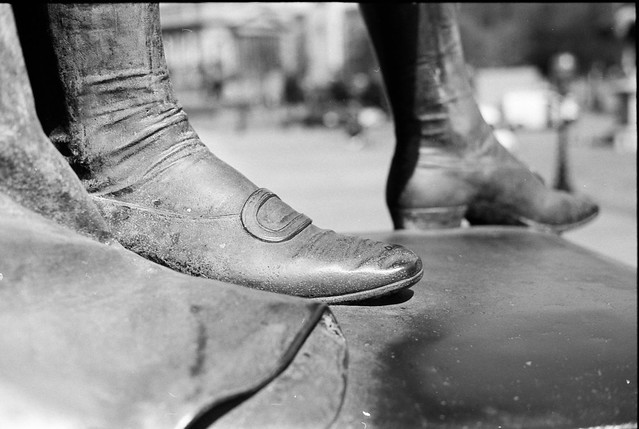

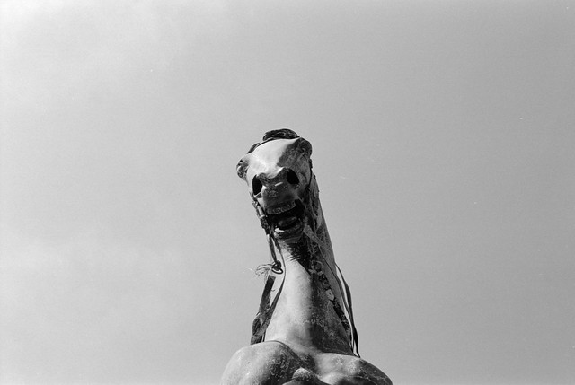

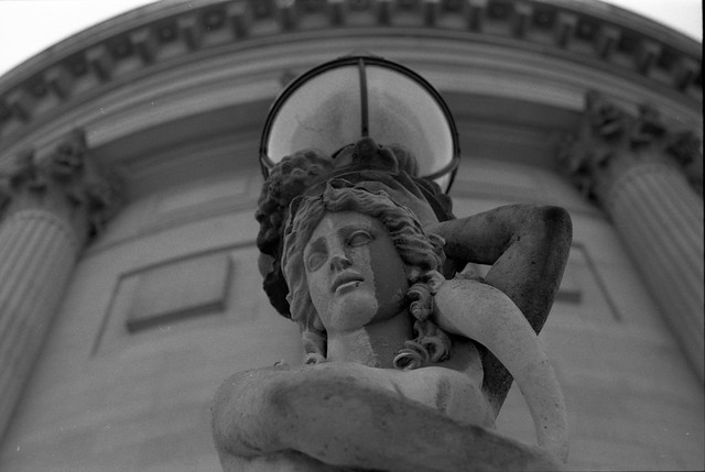

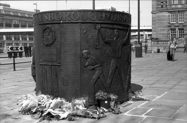

Well here are a few images off the roll. Rodinal 1+50. Had some terrible drying marks on them, something I haven't had for ages so a bit of work in LR to clean them up and a curves adjustment:
feet
by rednorters, on Flickr
mount
twoface
jft96

Nick, great set of shots, lovely tones from the Pan F. Nice subjects, captured well!

Four shots that have great tone, low on contrast, but wonderfully SMOOTH, I like them very much.
Congratulations on a winning combo.
