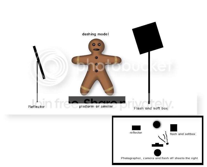

OK, I know nothing of flash photography, but I'm going to have a guess anyway :lol: Please see my professional looking diagram below:
One thing I missed of is a diffuser on the photographers flash.
Anyone caught laughing at my gingerbread man will be punished :bat: It was the closest thing I had to a person in my tubes :lol:
