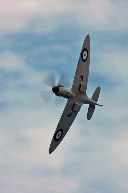

For the first time shooting planes I'd say 1/125 is a bit to slow and will result in a lot of OOF shots. 1/200 or 1/250 will still give decent prop blur on spitfires etc and if the OP is pretty confident with panning then drop the shutter speed on the slower prop planes
Hmm, maybe you are right although I shot at 1/125 from my very first prop plane because that was what I was told to do. Saying that I did have a lot of OOF shots :lol:
You learn pretty quickly though.

Helicopters are really tough, you need about 1/80 to stop prop blur, and with prop planes shoot around 1/320 to start with. For fast jets, just stick it on 1/1000 to make it nice and sharp, up your ISO slightly if you have to.
