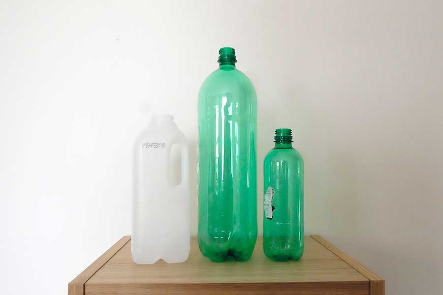

Recently started my own b&w film developing again and was just wondering how you store your chemicals. Do you stick with the proper, expandable accordion type bottles? What I was thinking was with a range of different sizes of 'recyclable' plastic bottles, water bottles, milk containers, etc, etc it would be quite easy to keep them full to the top whilst using as required, thereby extending shelf life in comparison to a single 'unfull' 5l container. Any issues with this approach?

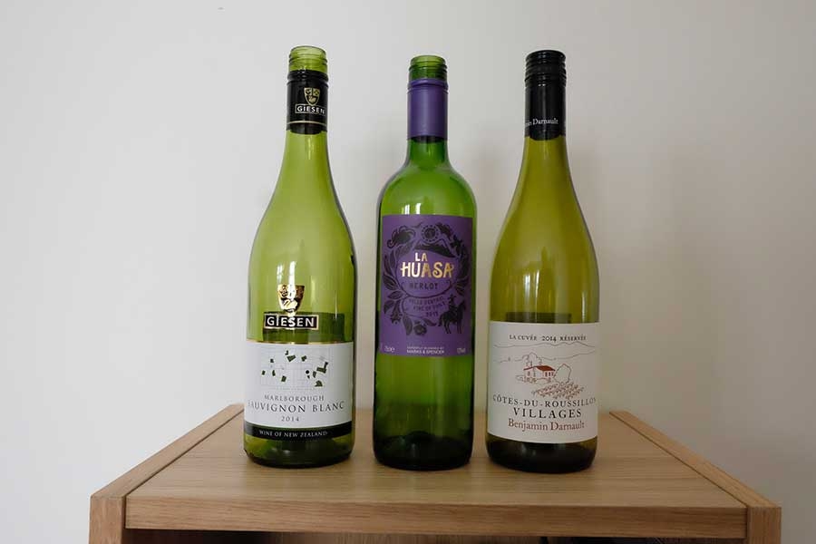

In re-closeble dark glass bottle and in a very cool place max 8°C.
What is the significance of 8°C?
I always store and develop my chemicals at room temperature. It means that my chemicals are always ready to go and I don't have to do anything tricky to maintain a constant temperature during development.
That's the temp of the deep cellar. Since I don't have to much
enlarging nowadays, I discovered that room temperature was
not good for the prepared solutions as they were aging too fast
in half full containers. When I need them, I just place the bottles
in a small tub to warm up.
No secrets… old tricks.
