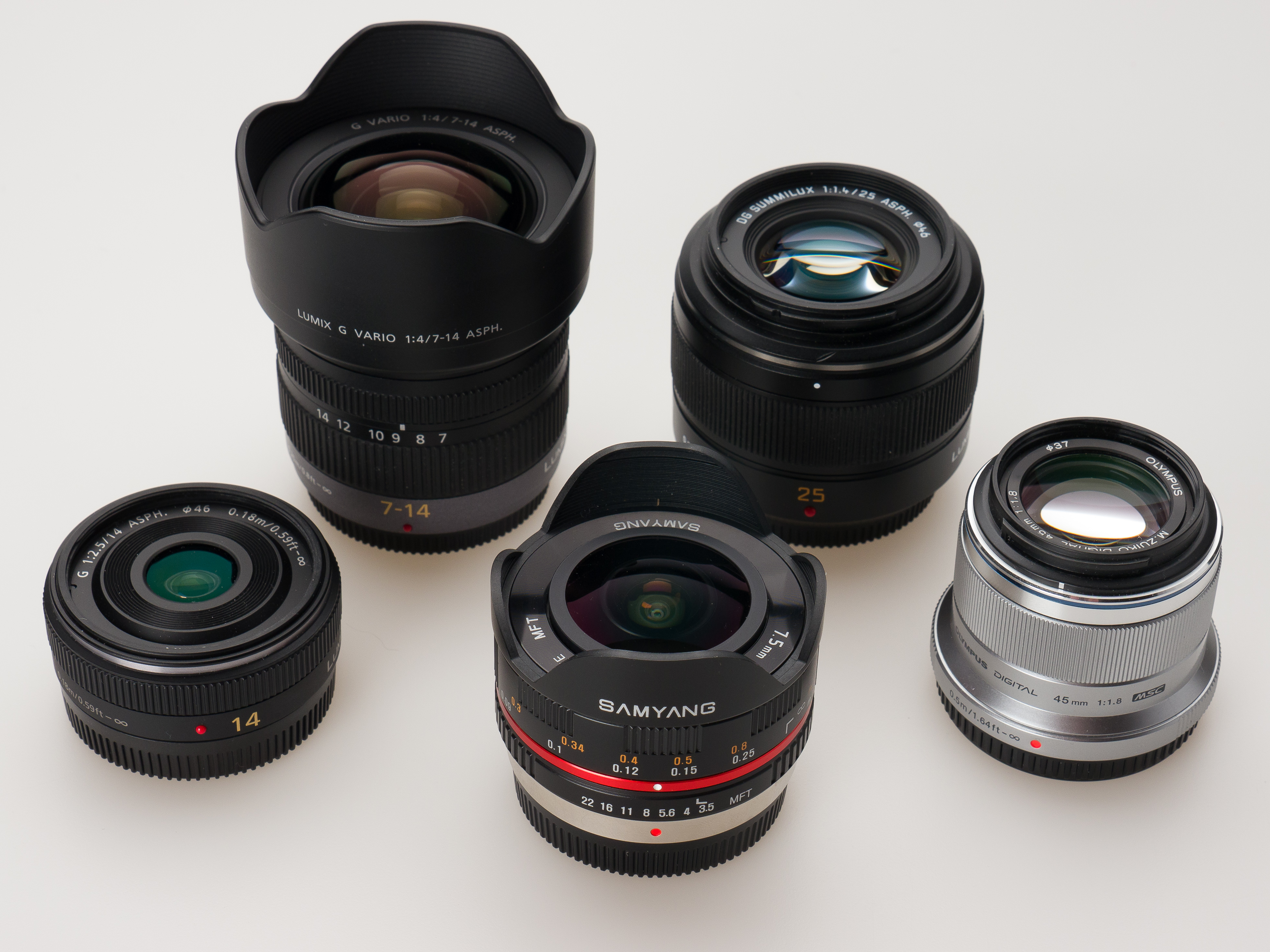

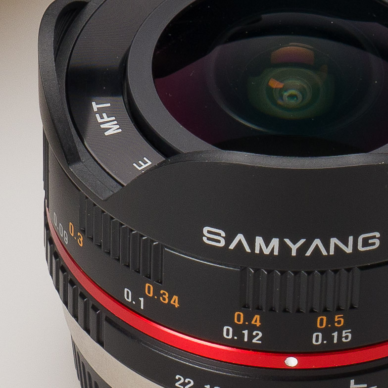

and if you want to see what the depth of field is like at f9 (this is on a micro 4/3 camera - the 550D will have slightly shallower depth of field) see the full image here:
http://www.arad85.co.uk/hosted/talkp/P1000395-full.jpg
