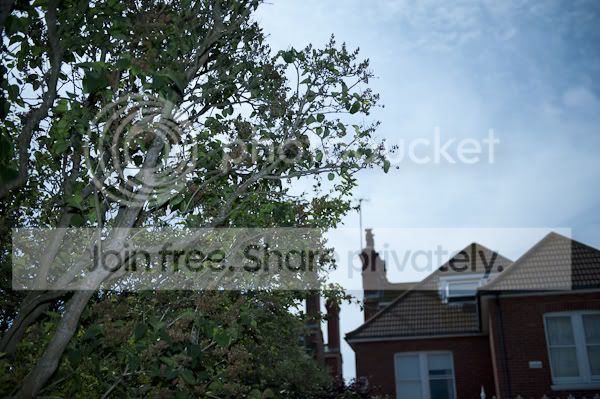

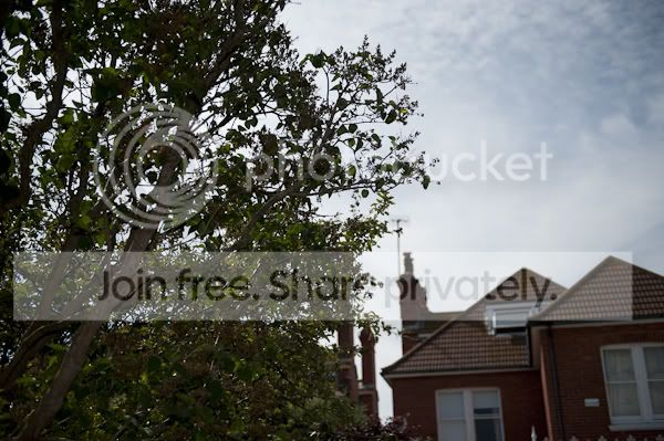

I've popped outside and taken a couple of shots to show the difference between shooting at max sync vs max speed.
Camera on a tripod. First shot at max speed, then second shot at max sync speed, using ISO adjustment and ND filter to give an equal ambient light. That way we can just see which shot provides the brightest flash.
1st shot - 1/8000, f2.8, iso200 flash on manual full
2nd shot - 1/250, f2.8, iso1600 (I make that 8 stops) + ND 9stop (who knows)
So, for max effect of overpowering the sun, I think you shuld stick to your max sync speed, and use an ND filter if necessary.
