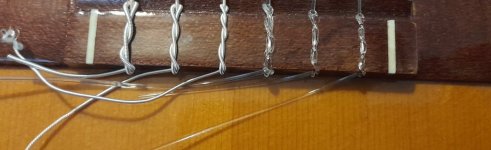

Currently in the middle of the mechanics of the knife edge tremelo system with lots of adjustments and restringing (it was on original 20 year olds!) to sort. Just resting my hand on the bridge was taking the tuning out, so new strings and fine tuning all the adjustments, to get the trem in the middle and the action correct, whilst still in tune, is the order of the day/s ahead.
Blocking the trem can help stability if that's an issue, unless you need to bend upwards. A little light oil or lipsalve can also lube the trem if it's a true knife edge type.
