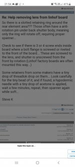

MHaving fone a quick search I came across this posting which mentions licking pins.
I had no idea that locking pins existed on some set ups .
Anyway who knows , it may offer some advice
Good luck!
I’ve had some overly tightened elements but never so much that I was unable to seperate from shutter though quite unnerving not knowing how much pressure could be applied.
Good luck!
Thanks...this is what I was wondering....something out of the norm....I will take a look. Thanks.
It seems that this may be a Linhof design feature....I will take a closer look tomorrow when I am less tired.

I have had another look and can't see any small retaining screws holding the rear lens element to the shutter......Next step, as suggested.....put it in the freezer......wish me luck!!! :eek::eek::eek:
